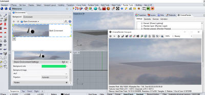

A test of the Rhino env shows me, that Rhino is updating the viewport, if the HDRI at the disk is changed. Great, the first step is done. But if I enable "Sync Octane Enviro to Rhino Enviro" then Octane doesn't follow the changes of the Rhino env. Attached a screenshot. Could this be fixed please?
Win7 64 | Dual Xeon E5-2687W | GTX 1080ti 11GB + GTX 780 6GB | Rhino3D

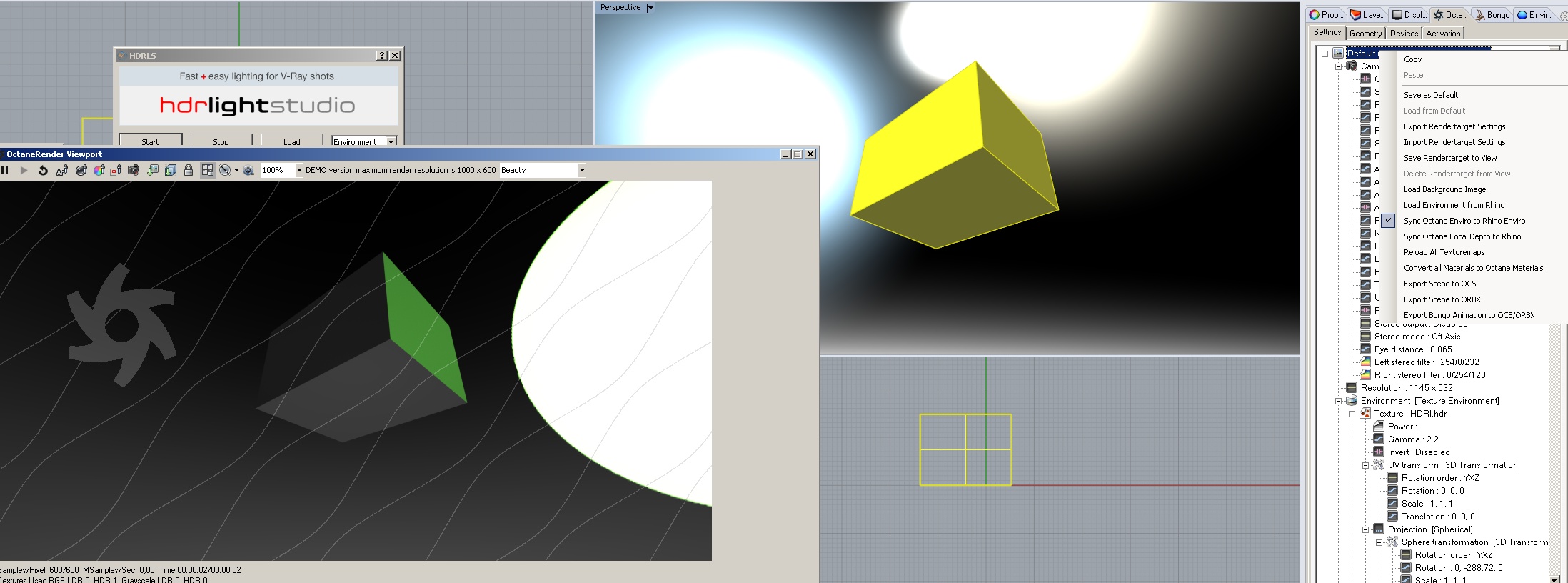

I don't have VRay for Rhino - so cannot exactly match your workflow. However for me it appears to be working correctly. For example, set the Octane Environment to Texture Environment with a Texture = RGB Image and tick "Sync Octane Enviro to Rhino Enviro". Then assign different Rhino Environment Background Images and Octane picks up the new image automatically. I did have to set the Octane Environment Texture Spherical Project Y Rotation to 90 to get an exact match (but I don't think that's needed if using HDR Light Studio). See image below. I wonder if VRay is updating the Rhino environment in a way which is causing the "Update Environment" event to not be triggered....A test of the Rhino env shows me, that Rhino is updating the viewport, if the HDRI at the disk is changed. Great, the first step is done. But if I enable "Sync Octane Enviro to Rhino Enviro" then Octane doesn't follow the changes of the Rhino env. Attached a screenshot. Could this be fixed please?

The "Reload All Texturemaps" works correctly if you have a texturemap in the Texture pin of a Texture Environment node. However when you have "Sync Octane Enviro to Rhino Enviro" ticked, the texturemap is coming directly from the Rhino IBL bitmap, and because Rhino is not detecting the file change, it's bitmap is not being reloaded, so the Octane plugin is not getting the updated bitmap in this case. There is nothing I can do in the plugin to get around this - you'll need to submit a feature request to the Rhino devs.The "Reload All Texturemaps isn't working for the env texture. Could it be fixed?
