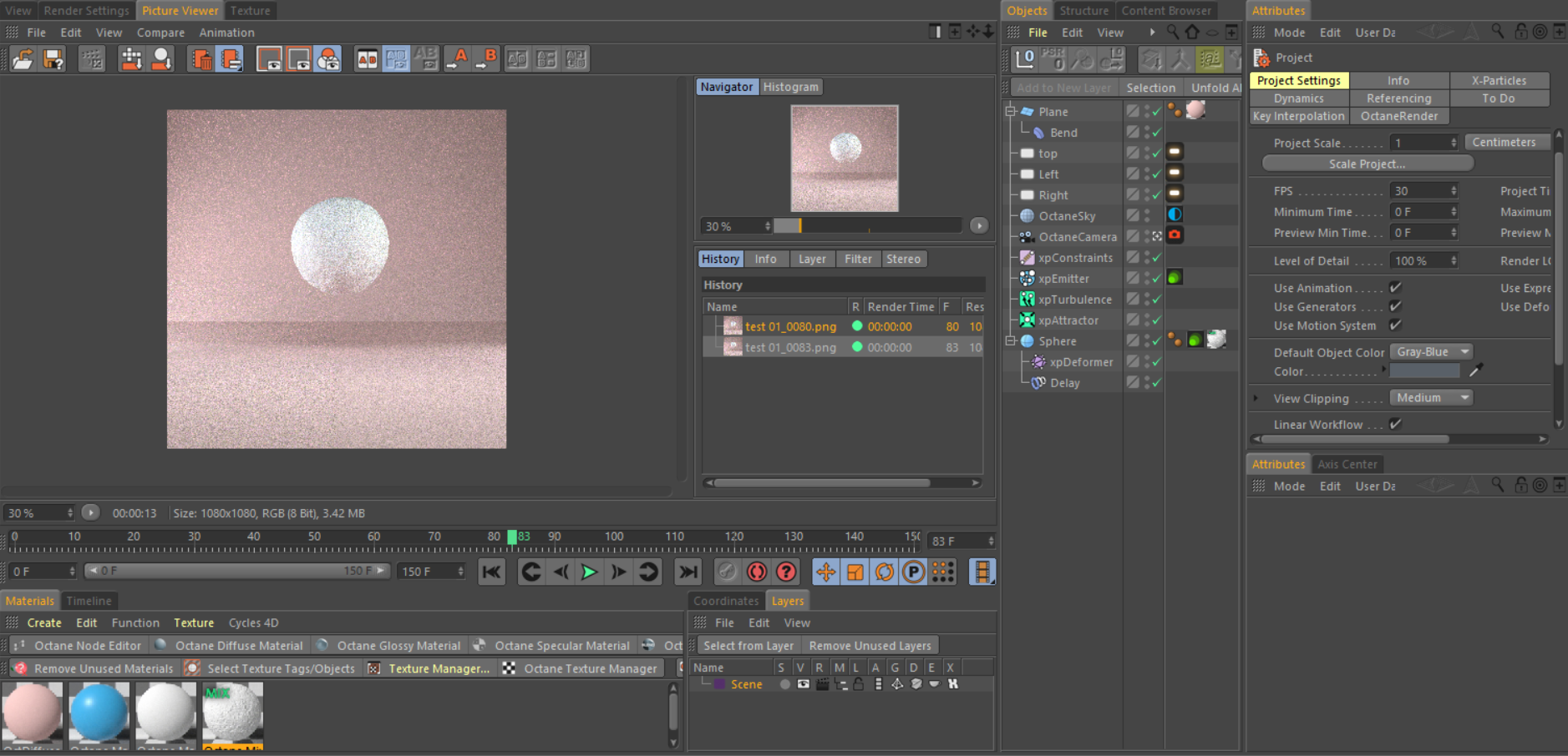

I made a scene with X Particles and Rendered with Octane. Everything is fine in Live Viewer but when i'm trying to render in picture viewer all the frames are the same. Only watch the first frame. I made a little research and i disable the xp cache, but i have the same problem.
Is something with Object Tags?
What should i do?

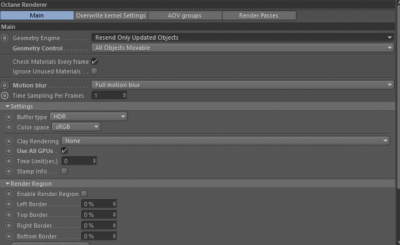

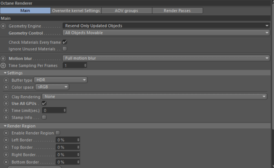

Please also share a screenshot from render Settings/Octanerender main tab, thanks.

An octane Log Report and a screenshot with main render settings.

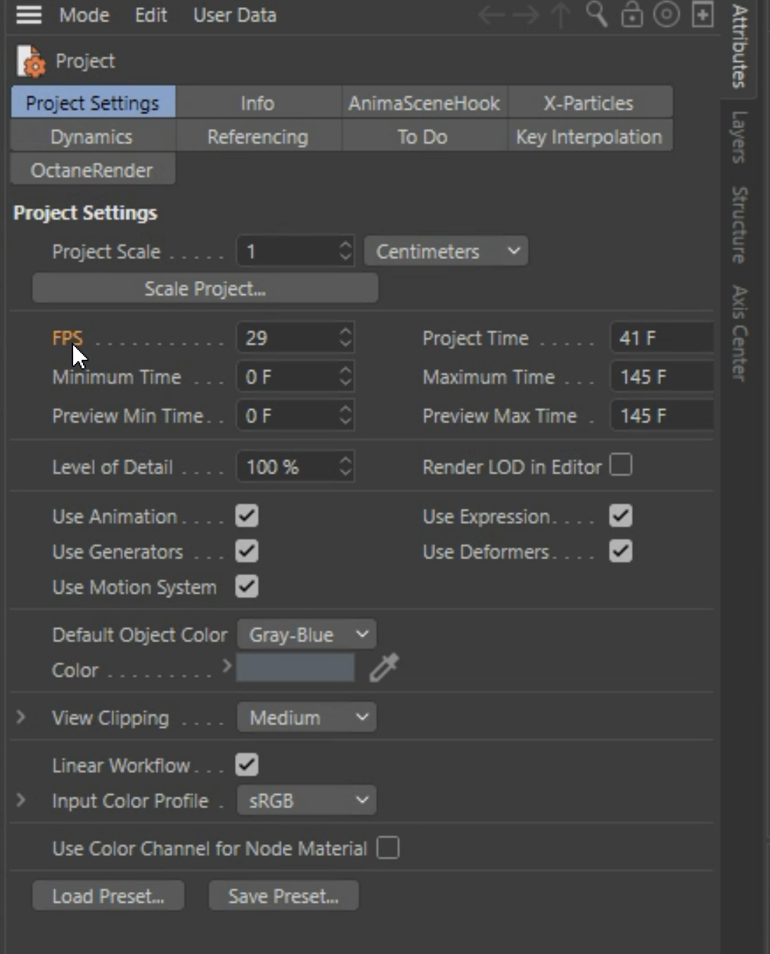

The issue was caused by an incorrect setting of the FPS of the scene, Render Settings was set to 30, while the Project was set to 29 FPS:

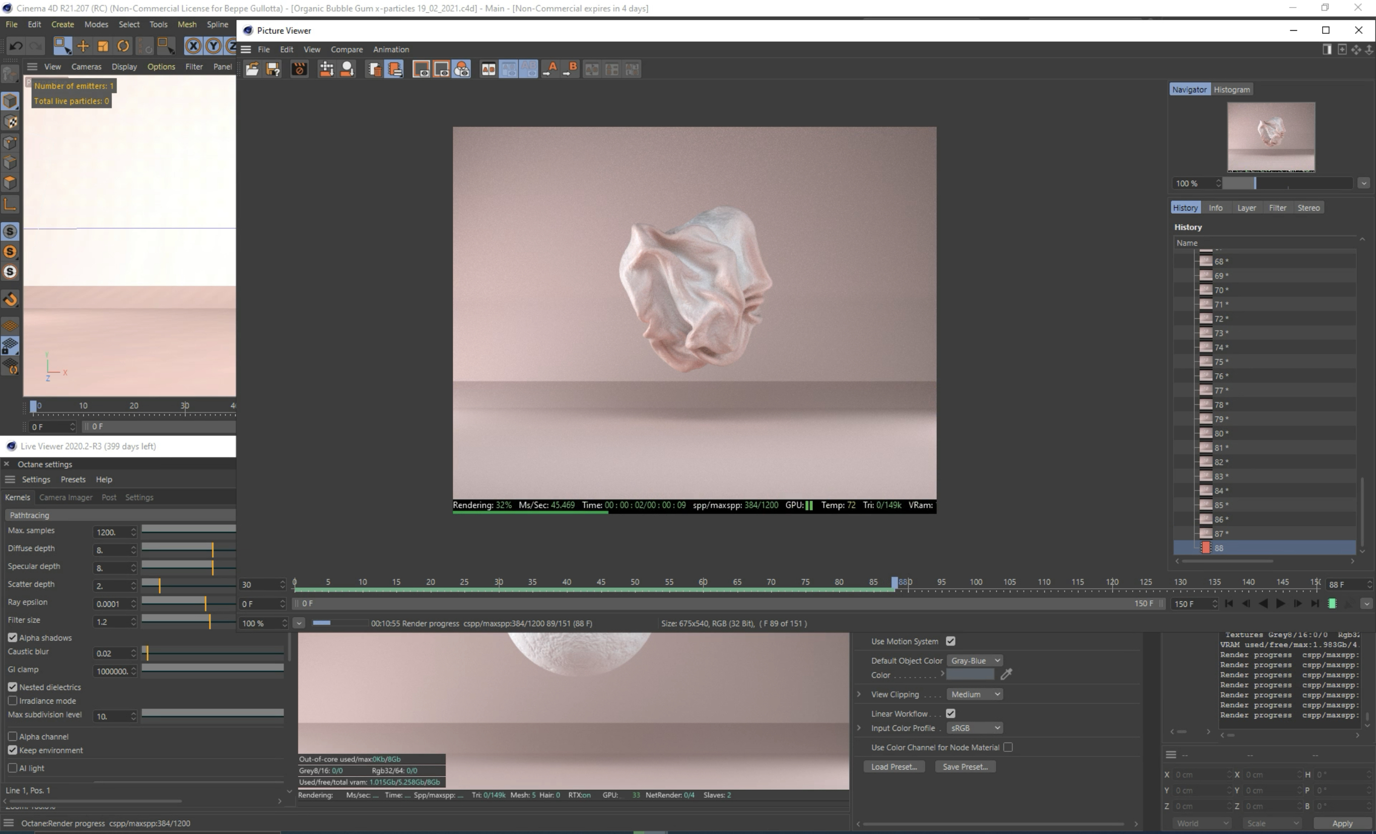

After correcting it to 30, the scene is rendering correctly also in Picture Viewer:
