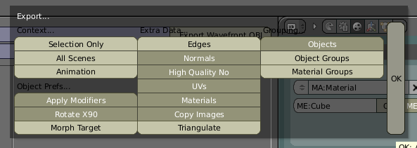

James wrote:Here are screenshots of OBJ export settings that work with octane, please share export settings for apps not yet in this list and I will pop them in this post.
In blender I usually add normals and HQ, at least it had done no arm so far.
radiance
Posts: 7633
Yeah, exporting the normals is needed, especially when using glass materials as the normal is used for the refraction.

thwak wrote:Is this correct for 2.49?
I also poke the HQ button.

I had a mesh ex Blender that kept crashing Octane.. very perplexing.
Finally found the culprit- a stray edge - dont export edges, Octane doesnt like it and doesnt give a specific error.
Better yet in edit mode use the built in script Clean Meshes to tidy up verts and edges.
Also I remind people to Remove Doubles, and Clear/Apply scale and rotation as good housekeeping habits.
