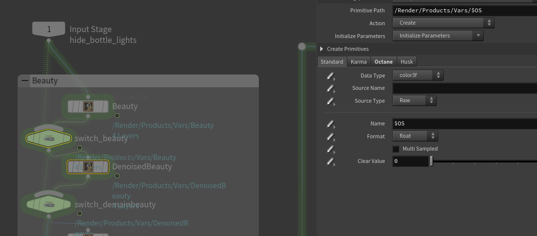

The denoise AOV format parameter is now set to float - this means when rendering to disk with USD render only the red channel of the denoise pass is getting written out. Needs to be reverted to color3f (or color4f, whichever it was). Also the Beauty > rgba renaming is not coming through USD render either. We're still getting black rgba and having to shuffle out Beauty.

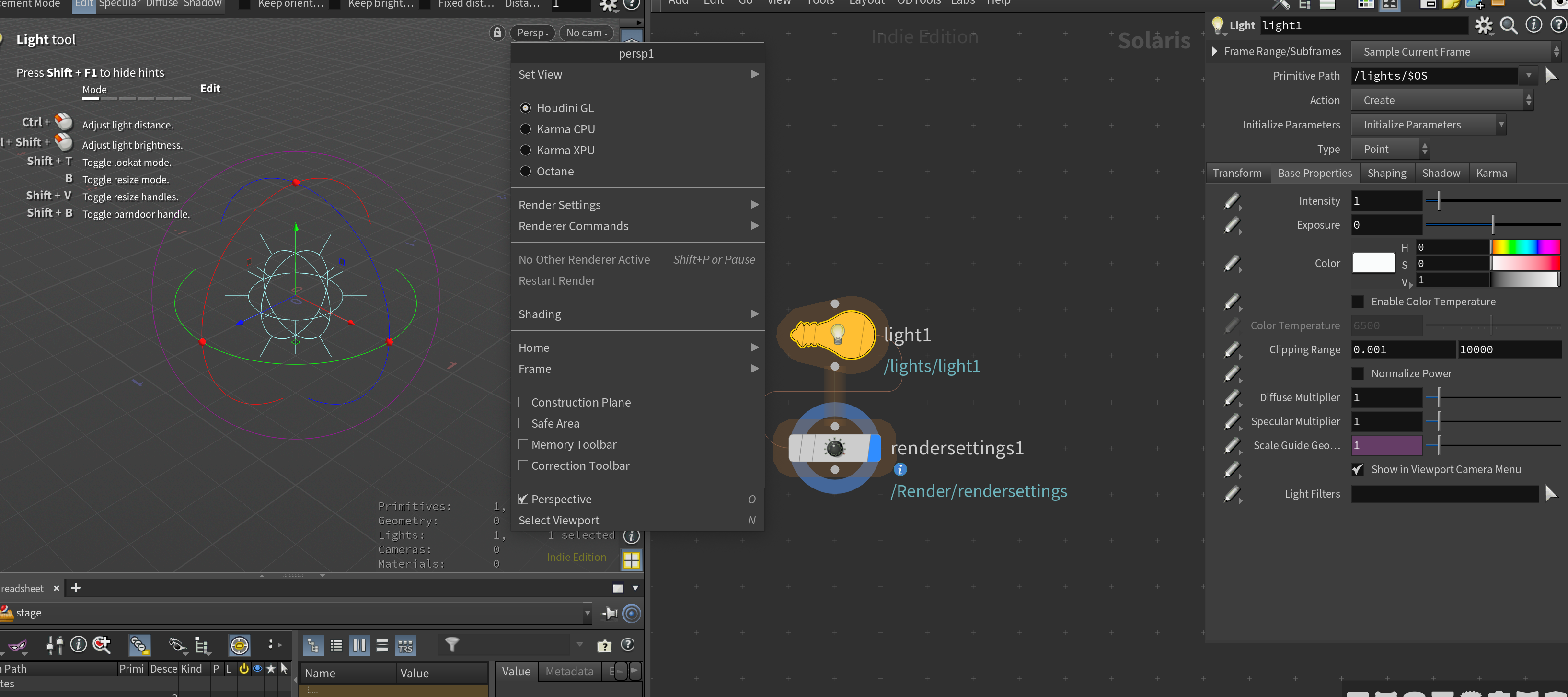

I'm trying to install the solaris plugin on my Mac Studio, the normal plugin works but how can I do to make the solaris part works ?

davidyannick_1 wrote:I'm trying to install the solaris plugin on my Mac Studio, the normal plugin works but how can I do to make the solaris part works ?
Hi David,
Thanks for the post.
OctaneSoalris should work if the normal plugin is working!
Is there any error? Please check if you can see Octane in the Stage workspace!
cheers

Here is my json :
Code: Select all
    "enable": true,
    "env": [
            "HOUDINI_PATH": {
                "value": "/Users/david/Downloads/Octane_2023.1.3.0_Houdini_20.0.653_macos_Prime"
            "PXR_PLUGINPATH_NAME": {
                "value": "/Users/david/Downloads/Octane_2023.1.3.0_Solaris_20.0.653_macos_Prime/dso/usd_plugins"
When I'm on stage, I have a reference in the viewport and in use render lop, but in other LOPS (light...) nothing about octane
Vasker
Posts: 1
Joined: Tue Mar 20, 2018 1:22 am
I had a similar issue, make sure you disable the OTOY path in the env if you haven't done so

Hi David,
Thanks for the json paths.
It might be the usd path is missing the *$* sign. Please try mine and let us know if that works!
cheers
OctaneSolaris.zip
(498 Bytes) Downloaded 132 times
Kind Regards
