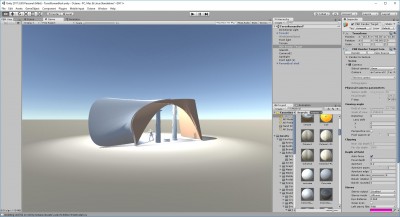

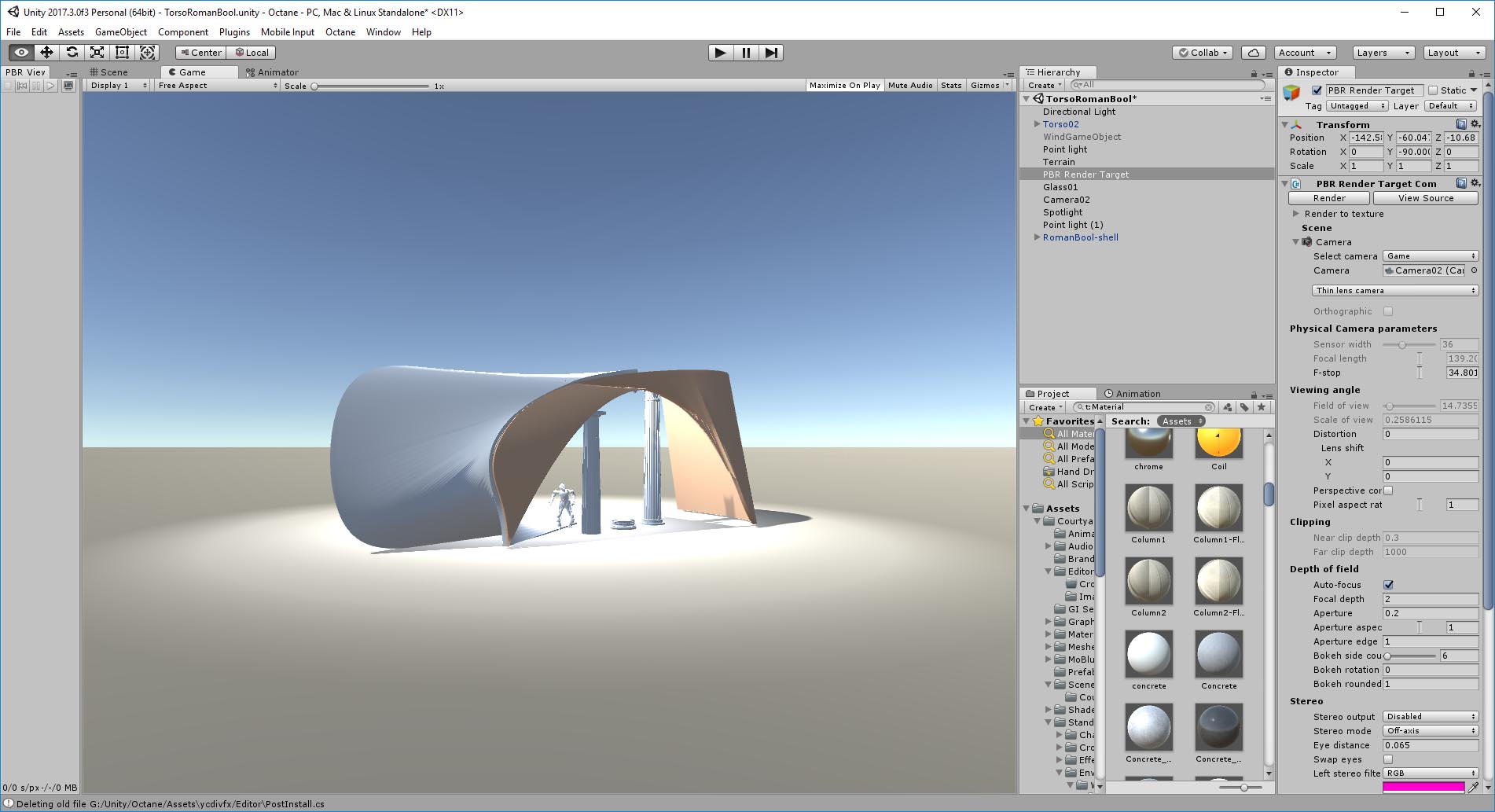

Postby wxyz » Wed Mar 21, 2018 10:40 pm
wxyz Wed Mar 21, 2018 10:40 pm
Cannot get the recorded render to match the moving camera. Camera settings attached.
wxyz
Posts: 68
Joined: Wed Nov 30, 2011 6:20 pm
