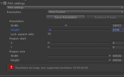

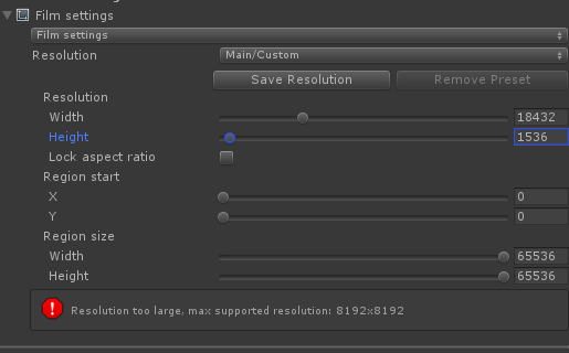

So I get an error when I try to bump it up. I am currently using the free version of Octane, so could that be the issue? If upgrading will allow for high res images, it would be worth it but I need to know that it is possible first. Also, how would I do a video like the ones on the ORBX Media Player page? Is that a different piece of software after taking frame by frame images and putting them together to save as a ORBX file (might be for the ORBX devs, in which I would love to talk to them too)?
