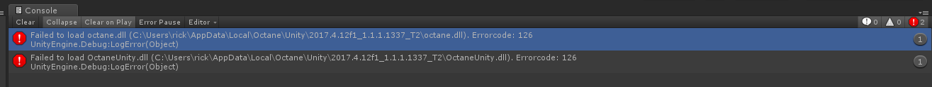

After "Installing" and "Loading Octane" render, two errors show up in the console:
Checking Unity license
UnityEngine.Debug:LogFormat(String, Object[])
OctaneUnity.<>c:<Check>b__14_0(AuthCodeResponse)
UnityEditor.AsyncHTTPClient:Done(State, Int32)
Failed to load "octane.dll". Errorode: 126
Failed to load "OctaneUnity.dll". Errorode: 126
UnityEngine.Debug:LogError(Object)
Octane.DynamicLibrary:Load()
Octane.PluginDllLoader:LoadLibraries()
OctaneUnity.PluginController:Init()
OctaneUnity.EULA:CheckRequest()
UnityEditor.EditorApplication:Internal_CallUpdateFunctions()

Windows error code 126 can have multiple causes. Mostly related to not being able to find the dlls.
Do you have folder C:\Users\%username%\AppData\Local\Octane\Unity\2017.1.0f3_1.0.0.918_T1\
When you start up the octane unity project do you get the following error message in the unity console?
"{libraryName} could not be found." or "OctaneUnity was not correctly installed."
Have you tried upgrading to OctaneUnity 1.0.0.963? (You should be getting a prompt, or you can upgrade in version control on the settings panel before you press load)
Note that in your unity thread you state you are using an "ATI GPU", and in this thread you are stating you are using nVidia?
This bug should not be related to a lack of an nVidia card, but you need a Cuda compatible nVidia card.
We have this problem currently with version 1337 on Unity 2017 LTS. Version 4.5f1 and 4.12f1. Version 1326 work fine. Problem only with latest version.
I tried just empty project. We got just 2 errors regarding OctaneUnity.dll and octane.dll. No warnings or any log messages.
Did you ever test your plugins before release? THEY ARE NOT WORKING on Unity 2017 LTS.
And we still get sharing violation error when installing version 1337. It is not fixed.

1.0.0.918 was a test release from August 2017, which can no longer be activated.AlanMattano wrote:Using Octane Plugin 1.0.0.918
According to your reply in the release notes topic, you received an error 126. Could you check the content ofmmortall wrote:I tried just empty project. We got just 2 errors regarding OctaneUnity.dll and octane.dll. No warnings or any log messages.
C:\Users\%username%\AppData\Local\Octane\Unity\2017.4.5f1_1.1.1.1337_T{?}? It should contain the following:
- libfbxsdk.dll
- octane.dat
- octane.dll
- OctaneUnity.dll
- OctaneUnity_1.1.1.1337_T{?}.unitypackage
Yes, we test our Unity builds before we release them. While we do test, we can miss things, and cannot test for all systems. I just did a test with a fresh project using Unity 2017.4.12f1, which worked without issues.mmortall wrote:Did you ever test your plugins before release? THEY ARE NOT WORKING on Unity 2017 LTS.
- libfbxsdk.dll
- octane.dat
- octane.dll
- OctaneUnity.dll
Yes, we test our Unity builds before we release them. While we do test, we can miss things, and cannot test for all systems. I just did a test with a fresh project using Unity 2017.4.12f1, which worked without issues.[/quote]mmortall wrote:Did you ever test your plugins before release? THEY ARE NOT WORKING on Unity 2017 LTS.
