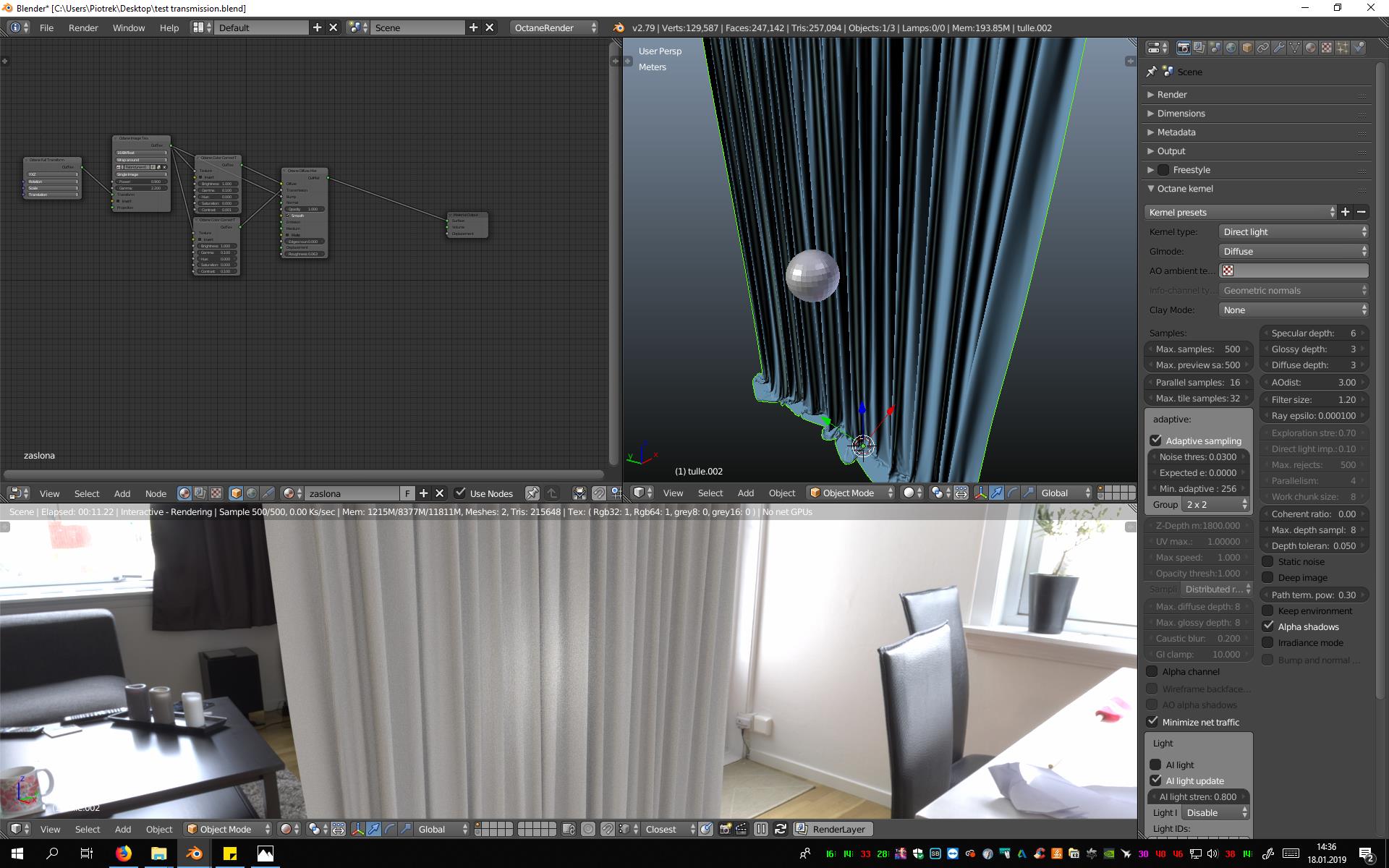

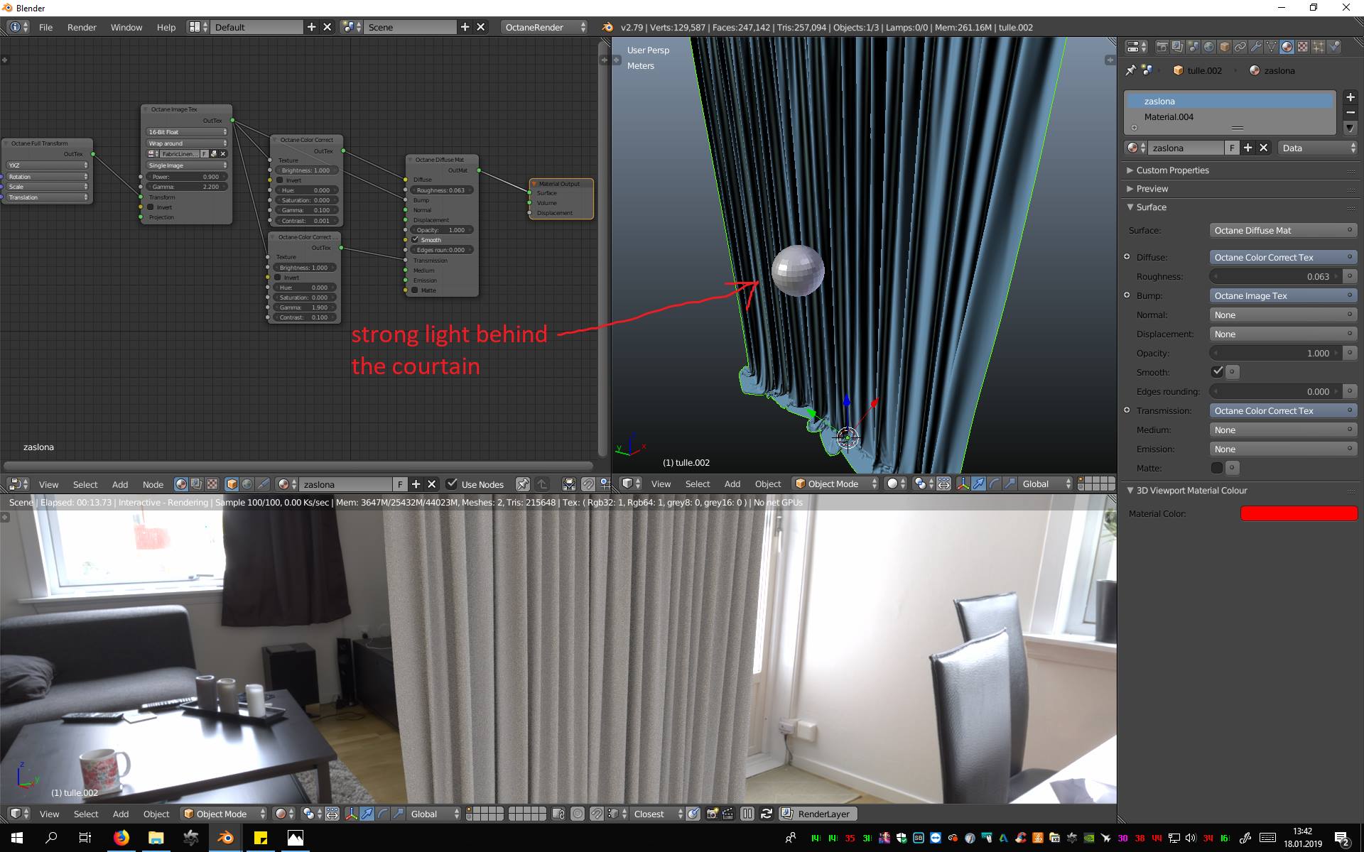

In versions 16.3.1 and higher, the Transmission input of Diffuse Material is not working. When plugging texture into Transmission input, nothing happens and the input is empty when checking it in Octane NodeGraph.
Version 16.3.1:
Version 16.3
Version 16.3.1
