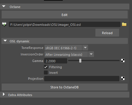

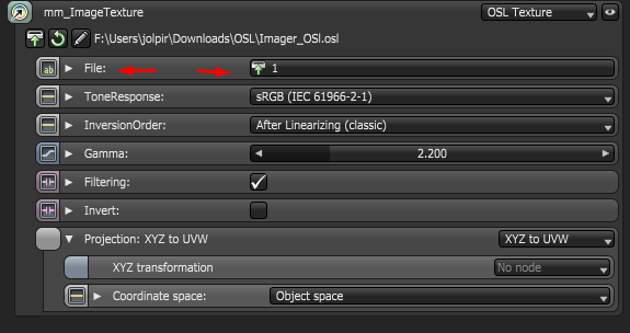

Here a OSL script which a problem on the plug but not on the Standalone. the file path case for the link is showing on the standalone but not on the plug.
Please find attached here the file.

Maya Missing part
Maya Missing part
Standalone
Standalone

JimStar
Posts: 3852
This is not a bug, but a user-error.
Please be sure you don't use in your script the names of already existing non-dynamic plugs of the OSL-node.
In your case the "File" input variable is conflicting with the existing permanent "File" attribute of the OSL-Texture node, so it gets not created as a dynamic attribute. Just change the name of this variable in your script to something else (e.g. to "FileInput"), and it will appear in AE as a dynamic attribute of a "string" type.

Hi Jim,
Okay I see, well would be great to work as Standalone so we can use the same OSL scripts without modified then for the plug only, I have multiple script on the standalone with the same file name and is working without errors? but not on standalone those script.
