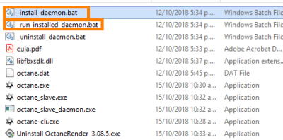

- Bring up an Explorer window then locate the Octane Standalone folder then run
_install_daemon.bat to install the slave daemon. You can press Enter key 5 times to set up as default or choose to set up manually.
- Run the

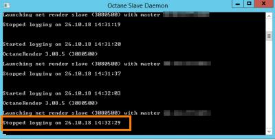

_run_installed_daemon.bat batch file. Make sure to keep it running.. **************************

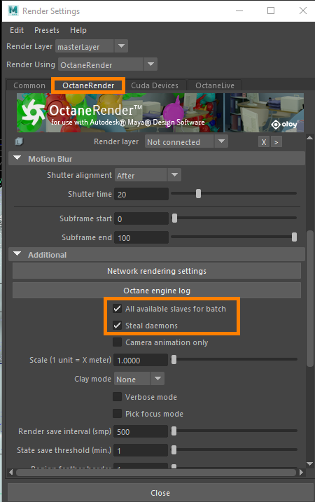

- Tick or enable the All available slaves for batch and Steal Daemons from the Octane render tab

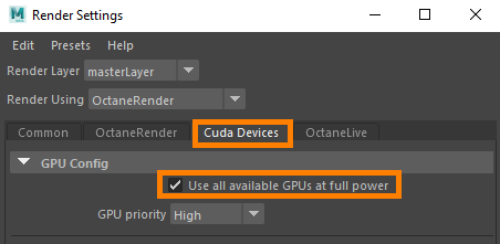

- And Use all available GPUs at full power from the Cuda Devices tab

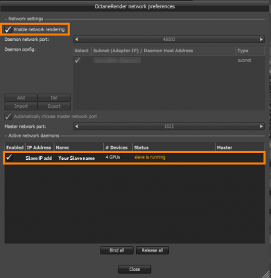

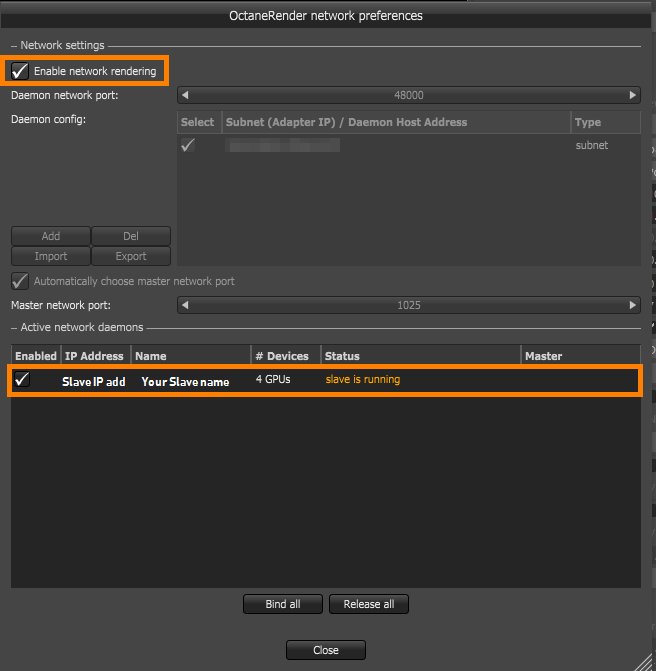

Now, to test the connection go to Octane Render tab and bring up the Octane render network preference dialog from Additional rollout "Network Rendering settings".
- Tick/Enable the Enable network rendering and choose your Slave daemons from the Active network Daemons field below and make sure the Status says "slave is running" then close the dialog.
- Run IPR to see the status. You will see the number of slave and GPUs. If the IPR session works then Batch render from render menu or Command line should work.
- For Batch render from render menu or Command line render. Open up the "OctaneRender network preferences" from the "Network rendering settings"
- And Untick or Disable the "Enable network rendering" option only no need to uncheck the Active daemons then close the dialog. This is because Octane render can have only one active connection with the daemon at one time. The slave daemon should look like this below:

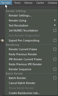

render -r octane YourfileName or click on the Render menu to do Batch Rendering. That's it..

Hi Braca,Braca wrote:Enable network rendering needs to be disabled if you want to do the batch.I had the same problem.
Thank you!! Octane Slave daemon allows only one connection at one time so, we need to choose using it for IPR or Batch Render.
Disabling the "Enable network rendering" from network preferences will free the Slave daemon connection from Maya IPR render session.
cheers
