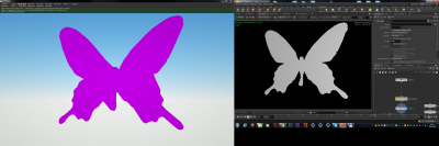

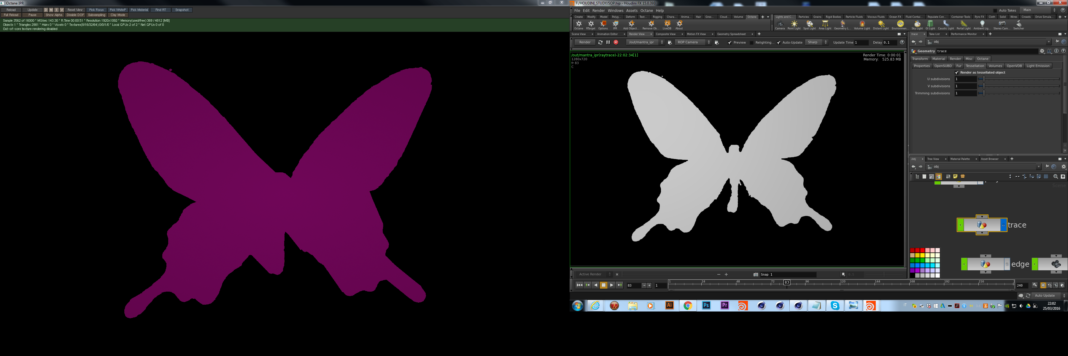

see my screenshot
with mantra working fine
trace non working fine with octane 3

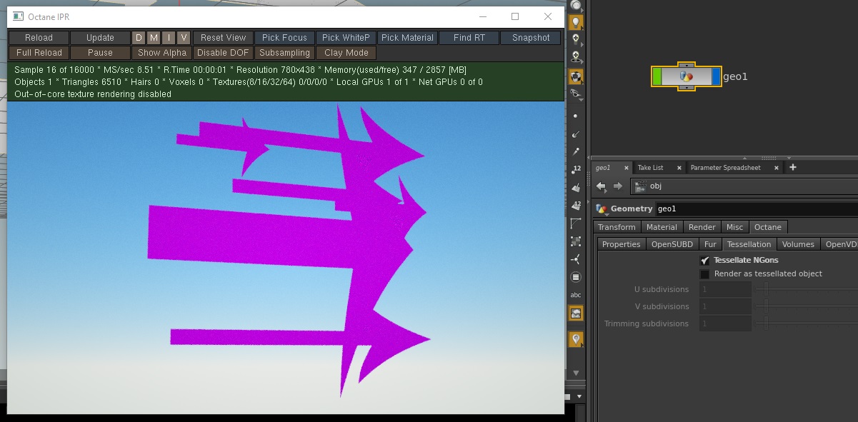

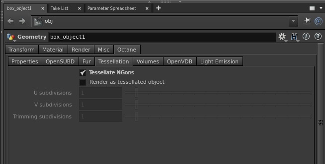

Sorry, I meant enable the "Tessellate NGons" option that is available in the last Octane 3.0 beta build, as you can see in the attached image.
viewtopic.php?f=102&t=52963
In earlier plugin versions you could use the Divide SOP node with the Convex Polygons option enabled.
https://docs.otoy.com/Houdini/?page_id=711
