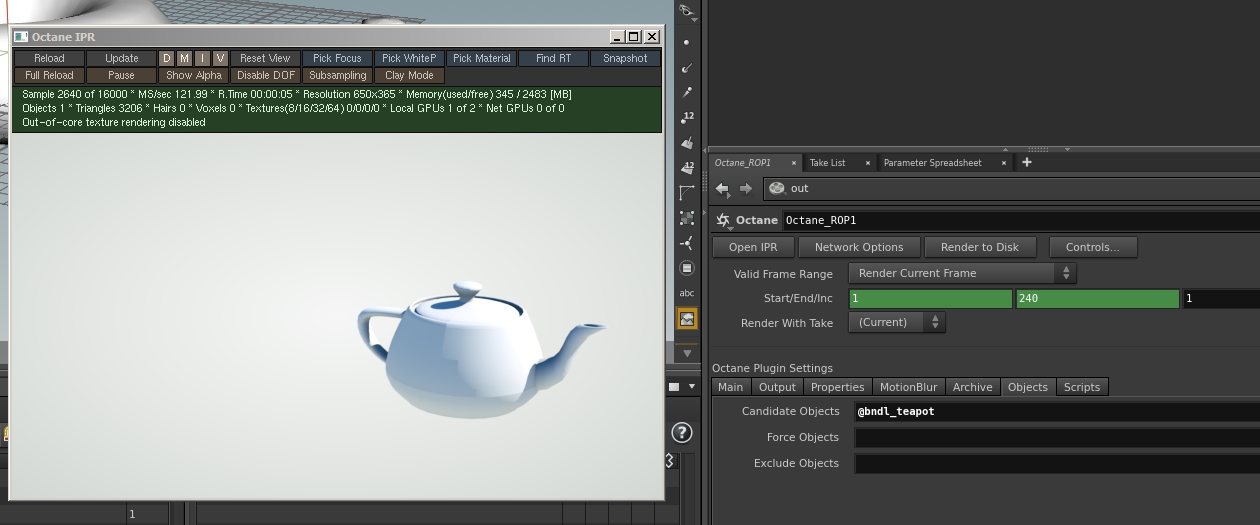

Bundles on the Octane ROP work fine as long as they are at /obj level. When I have objects in subnetworks and bundles pointing to them on the Octane ROP, it ignores them altogether. Only if I add the subnet itself to the bundle does it show up, but this is a different behavior than Houdini's bundle scheme if I'm not mistaken.
Attached a HIP with the issue.

Thanks for reporting this issue. I will try to fix it if possible. It is not clear why it happens, because the bundle lists from patterns are managed by the HDK using the globbing functions, that should work without problems with any kind of pattern or bundles.

I have found the problem. The Octane scene loader was processing the subnets after processing the bundle lists, so if the subnet was not in the bundle all the nodes inside were not loaded at all.
It will be fixed in the next build.
