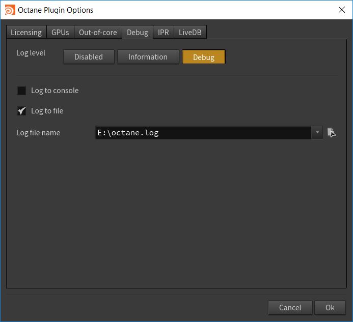

Ok, so perhaps your system can have problems to run Octane. What are your system specs, the GPU(s) and the NVIDIA driver version? A good test to know if Octane can work on your system is to install the Standalone version. If it works, the problem is on the plugin side for sure.
Also, we can check the plugin log file that you get after the crash. You can enable the log file in the plugin options panel. Please, enable it in "Debug" mode and attach here the log that you get after the crash.
Thanks,
-Juanjo
