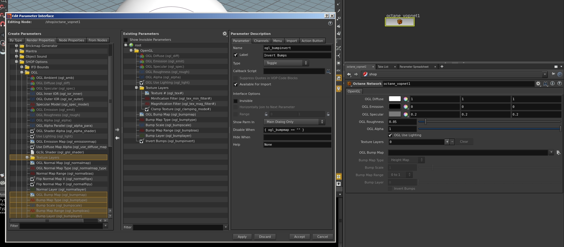

Postby sdanaher » Tue Aug 18, 2020 9:07 am
sdanaher Tue Aug 18, 2020 9:07 am
Ohhhh... thanks, that's perfect!
