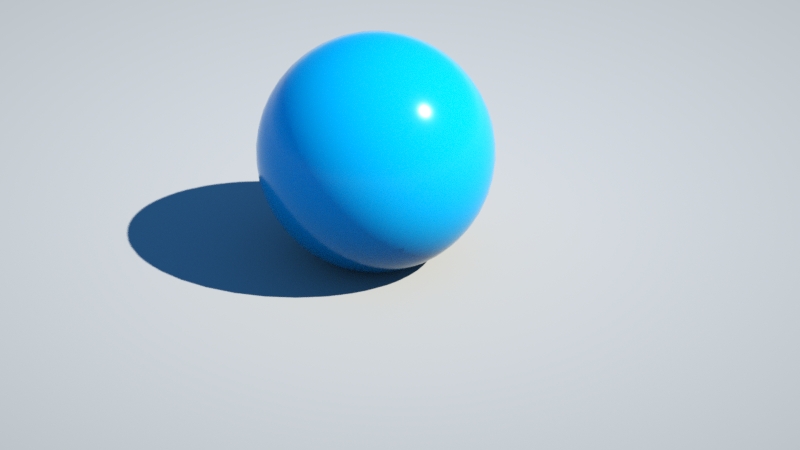

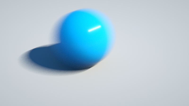

I installed version 3.04.4.0, now I have the problem that when the pass motion vector from render deactivates the blur...something wrong?
Thank you very much
This is with the pass motion vector on
This is with the pass motion vector off
juanjgon
Posts: 8867
Location: Spain
This is the expected behavior. If you enable the motion vector pass, all the beauty passes are rendering without motion blur to make possible add the motion effects in post.
