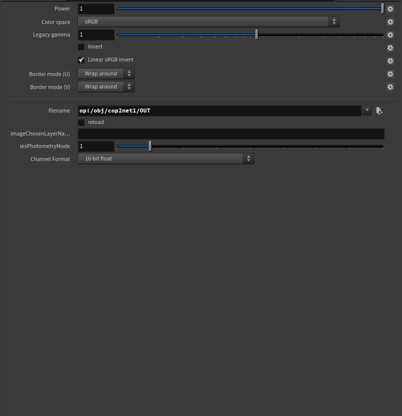

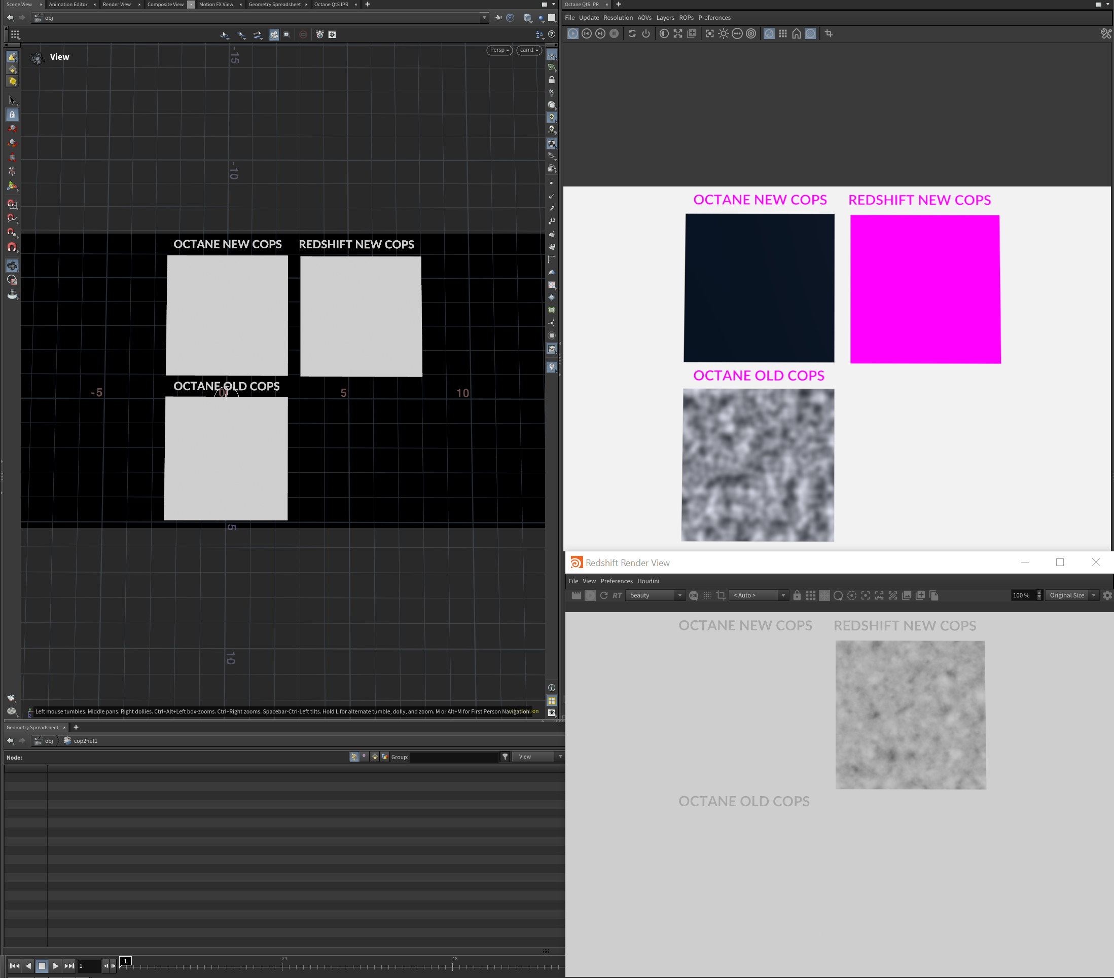

You use an expression to call the texture you want ( op:/path/to/copnet/node )ricky_otoy wrote:Hey toketronic,
I am not sure how Redshift handles it, can you send me a screenshot and more details?
You can try 20.5 already as the builds are available in releases.
In redshift it works in copernicus. In octane, it only works in old cops.

Situation is not great at the moment:
- I couldn't get the op: method to work
- plus, EXR files saved from new cop nodes do not work with Octane

For Redshift it did not work at first but Juanjo made a fix pretty fast
Let's hope the same goes for Octane regarding op:
