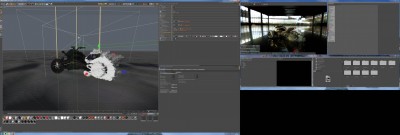

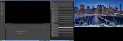

I tried to export this scene from c4d to octane cloud and you can see result.orbx file enclosed.
The result in octane standalone isn't working...
Soe explanations ?
Soe explanations ?

I don't know reason but this looks like same issue which i notified yesterday. Export is being broken when you have any volume object. Pls try without volume object. If it's fine so that's what i'm saying.bertritude wrote:Hi,
Soe explanations ?
If exporting from C4D to ORBX and rendering that in standalone fails, then that means ORC probably won't render the scene either since it is also running independently of the plug-in and depends on the export process succeeding.
I have not seen reports of C4D->ORBX export not rendering, but if that's the case for you, we need to confirm why this happens and fix that as a first step to getting it rendering on ORC.
