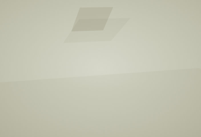

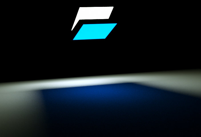

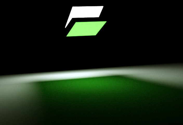

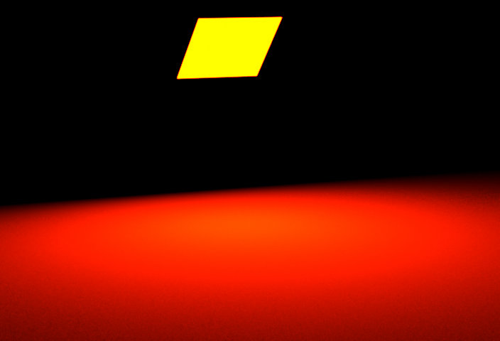

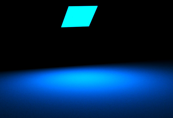

do you want the _light source_ to appear colored, or the emitted light? if second, then the temperature slider works indeed; 500 dark red, up to 12000 for bright blue; but it is only the temperature of the emitting body, not directly the wavelenght of the emitted light (it's a black body emitter still). as it doesn't emit coeherent light, you will never get a 100% "tinted" light that way. real world light sources (apart from leds, which emit coherent light) use colored filters to tint the otherwise white light;
the quick demo below shows:
1) floor, filter plane (specular), light plane (diffuse); standard enviroment light
2) blackbody emission at a temperature 500°C, filter plane set to white with ior 1 (~invisible), enviroment off
4) blackbody emission at a temperature 12000°C
3) blackbody emission at a temperature 6500°C
5) blackbody emission at a temperature 6500°C, filter plane set to red transmission with ior 8
6) blackbody emission at a temperature 6500°C, filter plane set to green
7) blackbody emission at a temperature 6500°C, filter plane set to blue
ps: this is still not real-world, as the light emitting plane is gigantic (50x50cm) - a real world light emitter (glowing filament of a light bulb) is a few centimers long and around 1mm thick (and normally it's light is additionally focused by a reflector)...
