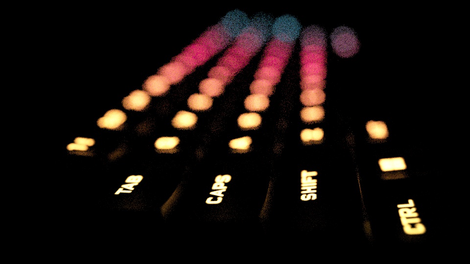

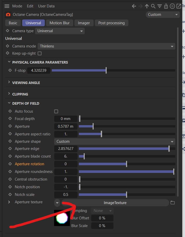

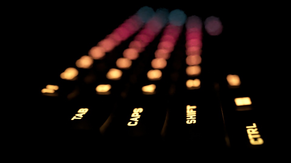

If a universal camera is used with a custom depth of field bokeh aperture texture, enabling the denoiser will cause the image to render darker than without it.
normal render
denoised render

This is unrelated to samples, the full final shots rendered here are on 8000 samples and render cleanly with no noise. They go darker. The images attached to this bug report use fewer samples to show the problem quickly.
It is literally a darkening bug caused by the denoiser.
