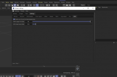

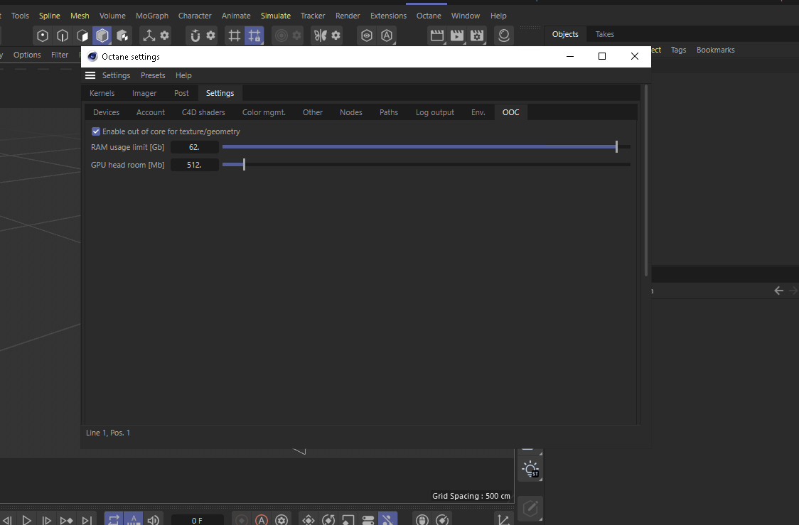

I tried to iterate and print all the keys and values in the container with ID 1029499, and I didn't get any key to set “RAM usage limit” or “GPU head room”, how can I use python to set the parameters in the out of core tab?
Any help would be appreciated, cheers!

You can find all the ID in vprenderer.h (c4doctane\res\description\vprenderer.h)
Here is some code i wrote a few months back but didn't have the time/resource to finish.
To be able to see the changes in the Octane Settings Windows you have to close it and reopen it so it can refresh the container. Same for the live viewer. (I hope this would change, it's very tedious to do anything in C4Dpython with the base containers. Redshift is much more simple since everything related to rendering/OCIO is located inside a VideoPost so it's really straightforward)
Hope it can help :)
