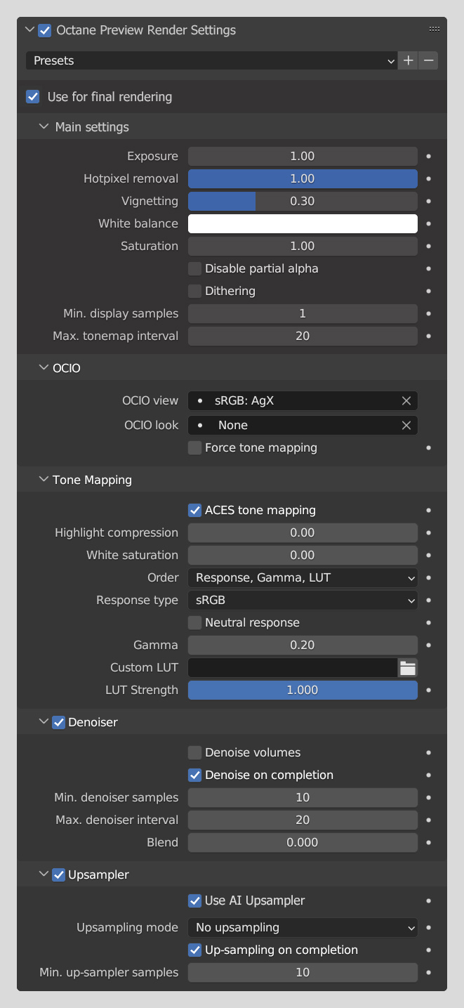

Hello,
the current workflow to Override Imager/Post in viewport has two steps. First you have to select the checkbox next to the Header name, then another checkbox called Override. The Override checkbox is grayed out when in camera mode and it shouldn't be grayed out.
I propose to keep only one checkbox - the checkbox next to the header when enabled will automatically override any camera imager and enable Imager settings from this panel. I also propose to change its name to "Octane Camera Imager (override)" Now it has "Preview mode" in the name which is not exactly true as it also works in final rendering mode.
Same with Ppostprocess settings.

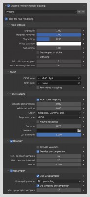

Here's a quick mockup that I created. This would make much more sense to me - and probably new users as well.
Some points ...
*) If "Use for final rendering" is checked, the preview settings ARE the render settings. This will also override the "Camera Image (Render Mode)" if checked.
*) If "ACES tone mapping" is checked, the other settings in the "Tone Mapping" section should be grayed out to underline that they have no effect.
*) I hope that I understood the AI Upsampler confusion correctly. Otherwise ignore that section.

ad 1) There might be a misunderstanding here. There's no doubling. This checkbox simply means, that whatever is set in the side panel, will also be used in final rendering - possibly overriding the Camera Imager RM. Checking or unchecking it will not result in any visual changes of the preview. It's just a flag variable.
ad 3) As I stated, I was not sure if there is a separate AI Upsampler in Octane. If not, this would be doubling indeed and the AI checkbox can be removed. But then the checkbox of the category should be respected. As of now, it's not.

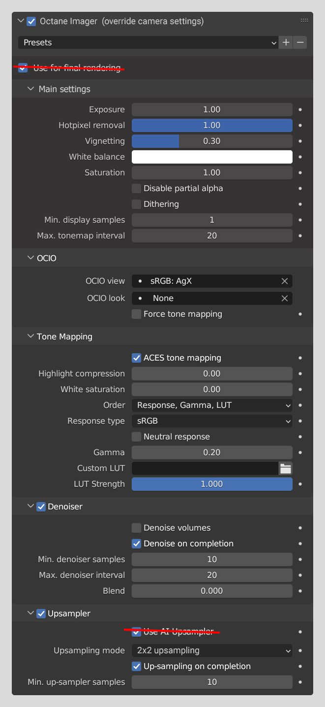

J.C
Posts: 1880
Joined: Thu May 13, 2010 6:35 pm
Location: Wrocław
Updated UI with description in header - (override camera settings)

J.C wrote:Updated UI with description in header - (override camera settings)
But how would that make it possible for me to render without having to adjust the preview settings beforehand? I guess I would always have to uncheck the side panel checkbox and that's where I already am right now.
