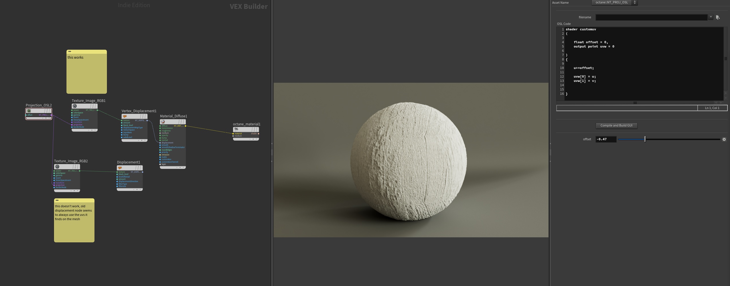

Hi! Thanks for the response. Yes, I'm using the vertex displacement. I can get good results when referencing the internal U and V OSL variables, but when I use arbitrary attributes to set my UV coordinates, all displacement goes flat.

Can you show me the shader tree ? Perhaps you're using that in the wrong type of osl shader ? It also looks like you're using the components of a color input to use as uvw coordinates so my first try would be to import the uvs as point also

Thanks again for the reply. Importing the attribute as Point type doesn't work correctly, but it does work fine as Color - and works as expected when the output is fed into BaseColor. It just fails as a displacement. Oddly enough, if Auto Bump is enabled, then I get the artifacts of the bump map, just no displacement. The only way I have been able to use a texture as a displacement source is if it is using the standard UVs (1-3) or it is manipulating those standard UVs through OSL. If provided and an entirely fresh set of UVs from and attribute, they work just fine everywhere but displacement.

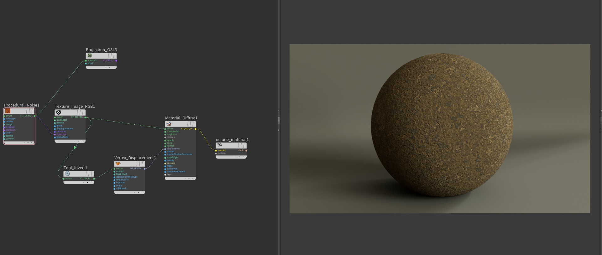

I discovered a new trick btw : Using a procedural noise as uv coordinates gives really nice results, and no seams of course :p
It also work swith vertex displacement
Out of curiosity : why do you need to import uvs from an attribute ?
