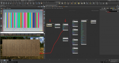

I've got the following issue: I would like to use the colour attribute of the underlying geometry, to drive the offset for a texture I intend to use in the material for this geometry. In my case, I'd like these colour values to affect the texture offset for each little bar of wood.
In both Redshift and even Unreal Engine, piping a colour value into a transform/translate input means that it will use the red and green channels for X and Y, therefore giving me a different texture offset for each piece of wood.
In Octane, I've tried piping the Color Vertex Attribute node into the translation input of a Transform 2D node (that controls the albedo texture), but unfortunately it doesn't work.
I then tried to find any utility nodes that would let me turn the Color Vertex Attribute node's colour output somehow into the 3float input the Transform 2D node expects, but there doesn't seem to be any combination that can do that either.
Would you have any idea, how I would be able to use those colour values I've got on my geometry to drive the texture offset as described? That'd be great!

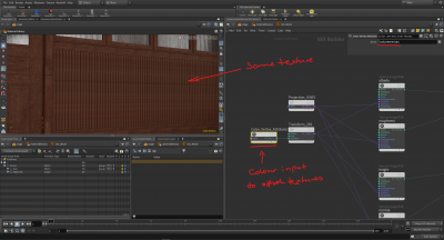

OK, so reading through the other post, it seems like this should work a) within the Solaris context (which is how my current setup works) and b) using non-instanced geo as well.
I've tried, using this setup, which - at least in my mind - should work:
But what I get when doing that (and then firing up Octane) are the following console messages:
Code: Select all
unknown Octane pin or attribute ID: HO_OSL_rawCode type: string
unknown Octane material node PinId: rndm
Any idea what's going wrong here? Thanks for letting me know :)

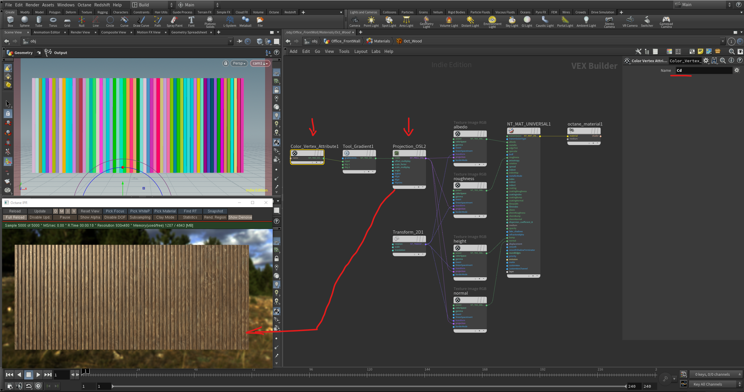

Either way, I dug a little deeper in the /obj context and actually managed to make this setup work, by declaring the "Cd" variable under "Vertex Vector Attrs." in the Octane Parms as you can see here:
So this works, offsetting the texture as expected. Hooray! :D
Unfortunately this same setup throws up the error as discussed, when using it inside Hydra/Solaris :cry:
