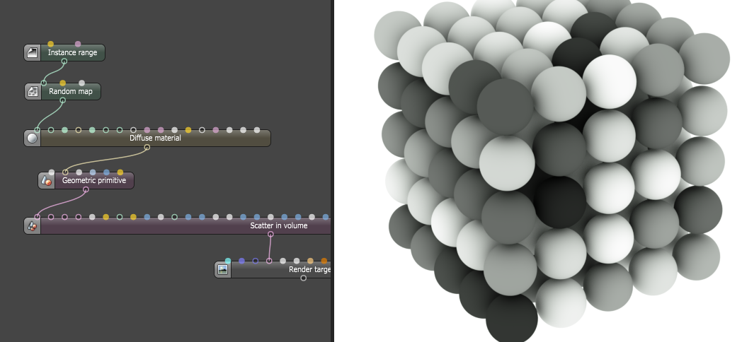

For random numbers uncorrelated between neighbor instance ids you can use "Hash" noise instead. Something like this:
Code: Select all
float c = noise("hash", _getinstanceid());
To simulate a seed you can multiply the instance id by a number.
Note that you can also do this without OSL using the "Instance range" and "Random map" nodes.

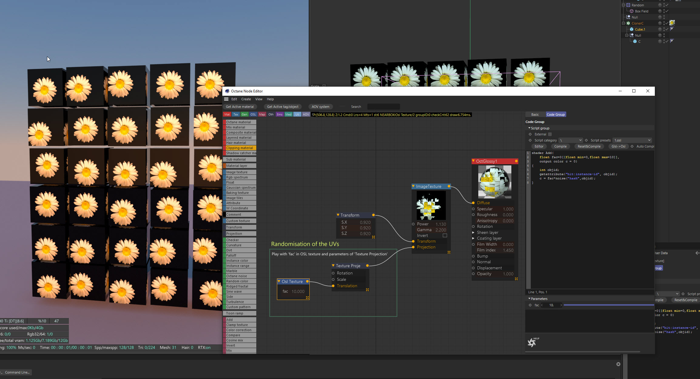

Another try to do something similar
1.rar
(159.1 KiB) Downloaded 151 times

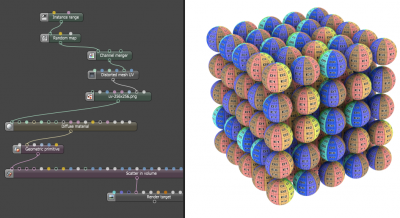

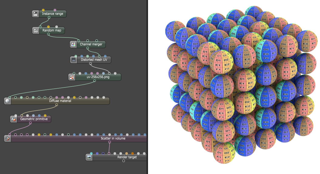

As I wrote you can do uncorrelated random numbers without code, using Instance range and Random map on hash noise, in standalone it would look like this:
To randomize UVs with this you can send it into the "Distorted mesh UV" projection.
