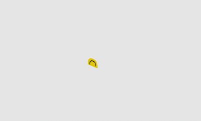

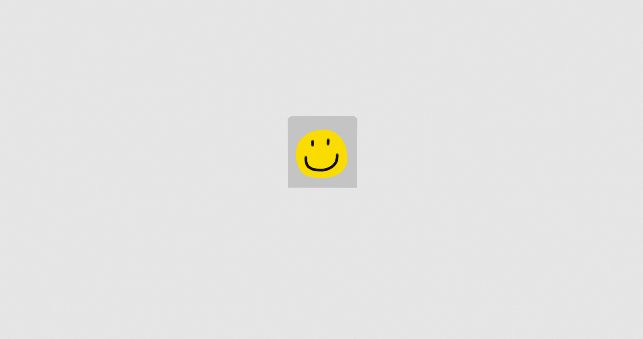

I am trying to get Camera Projection working in Octane. I have created a Cube and a camera for projection. I painted over the rendered image from the camera projection:
Paintover
Paintover

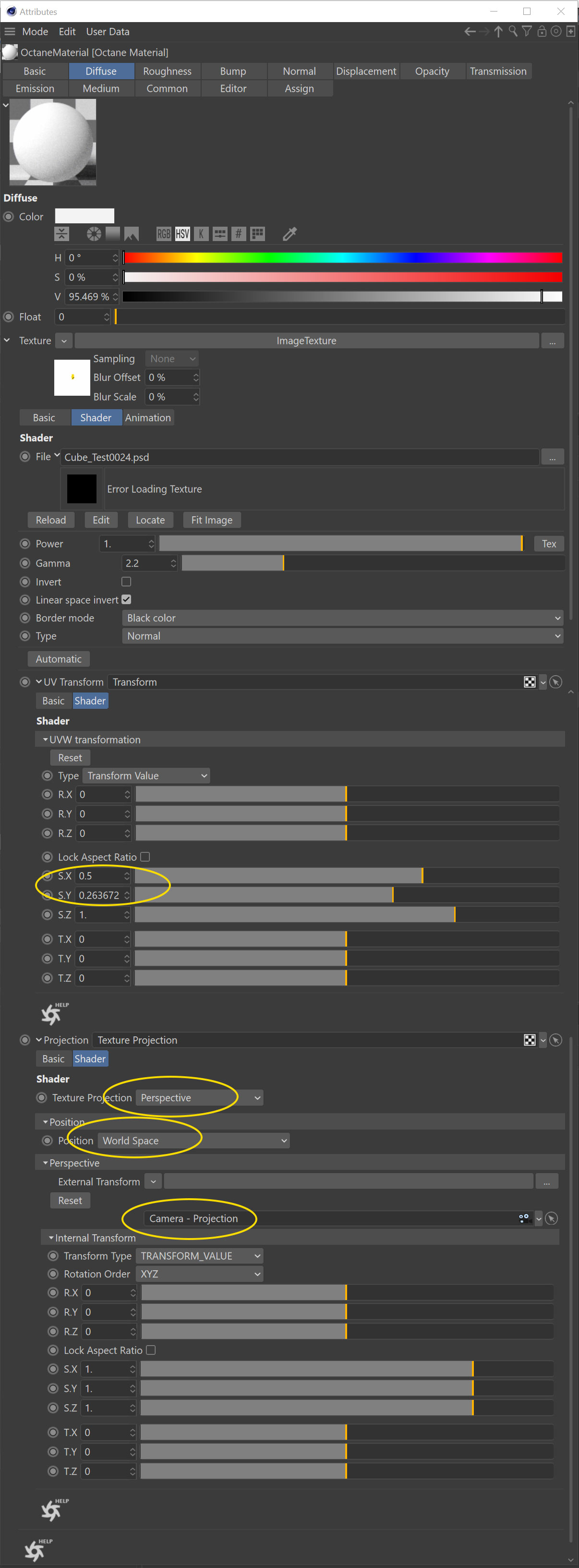

I have followed these steps as can be seen in this screenshot:
Material
Material

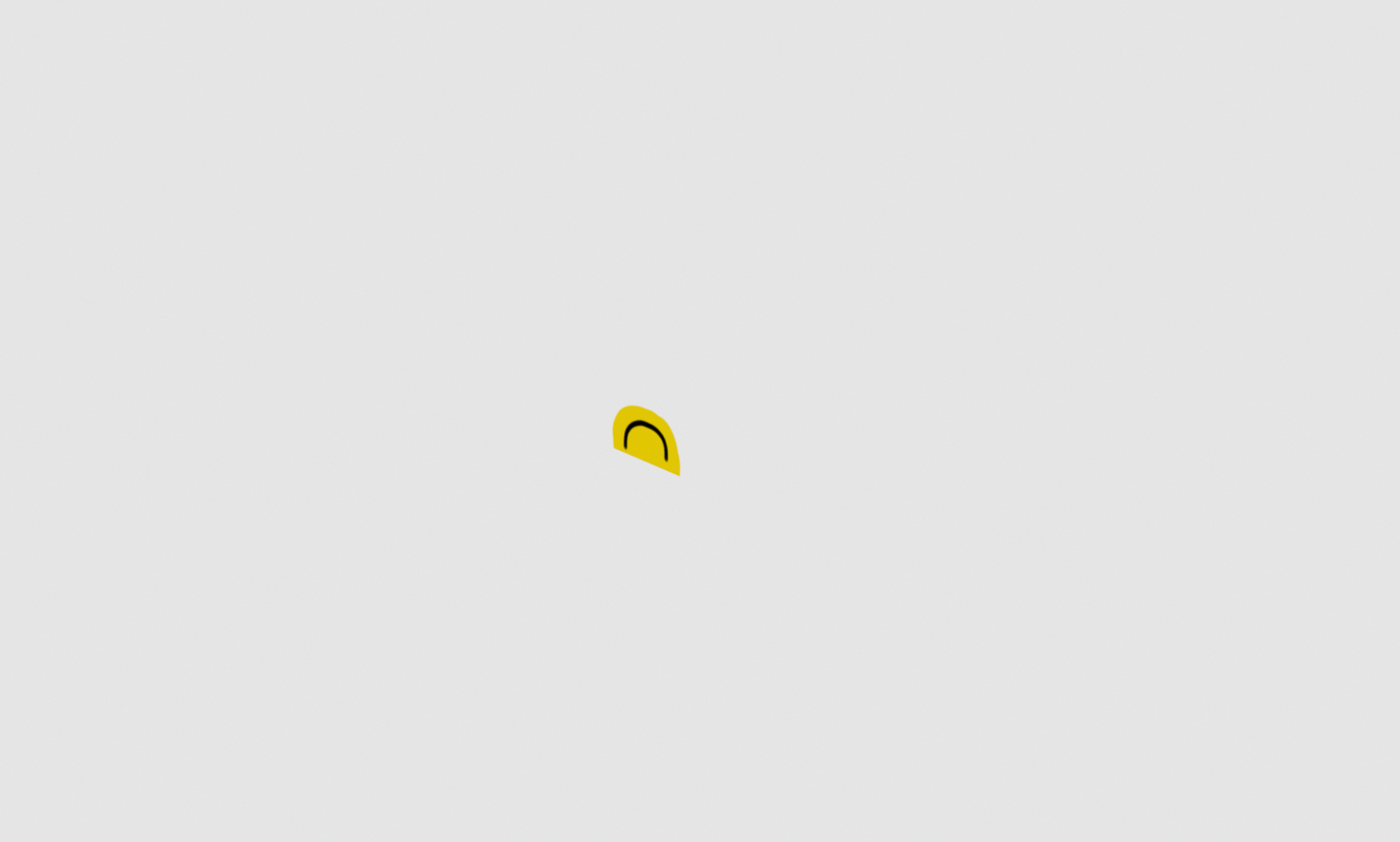

For some reason, however, my textures are coming out misplaced and upside-down:
Render
Render

I've been able to correct this particular example file by rotating the UVs in Z by 180 degrees, but that doesn't always work on my other files with the same setup.

please try these steps:
- set the UV Transform X scale to -1, and the y scale to -1*weight/height
- use the Projection Z scale to zoom in and zoom out
The Camera Projection position should be orthogonal to the cube, now it is not.

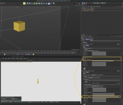

Hi Beppe,
Thank you for the reply. I'm sorry, but this isn't what I was hoping for:
  • This method seems really inaccurate. How can I get the right values every time? I don't want to be guessing with a scale factor that goes to the millionth's place decimal.
  • As with Cinema 4D's camera mapping, I should be able to project an image that isn't orthogonal to to the cube.
