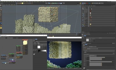

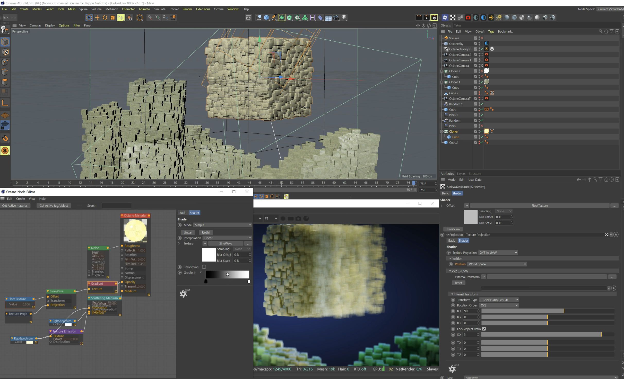

Any workaround on how to make a cloner grid to start from 100% transparency to 0 transparency in Octane? I mean a 3d linear gradient transparency covering the whole cloner. I have seen some workarounds but they're either old or not related to Octane! like this one for example:
viewtopic.php?f=30&t=51830
That transparency through the cloner boxes is exactly what I want, but is it really the most recent method for latest version of Octane? I need this feature a lot in my works but still cannot get it to work. There are many experts here and I wish I can get your advice.
Thanks in advance!

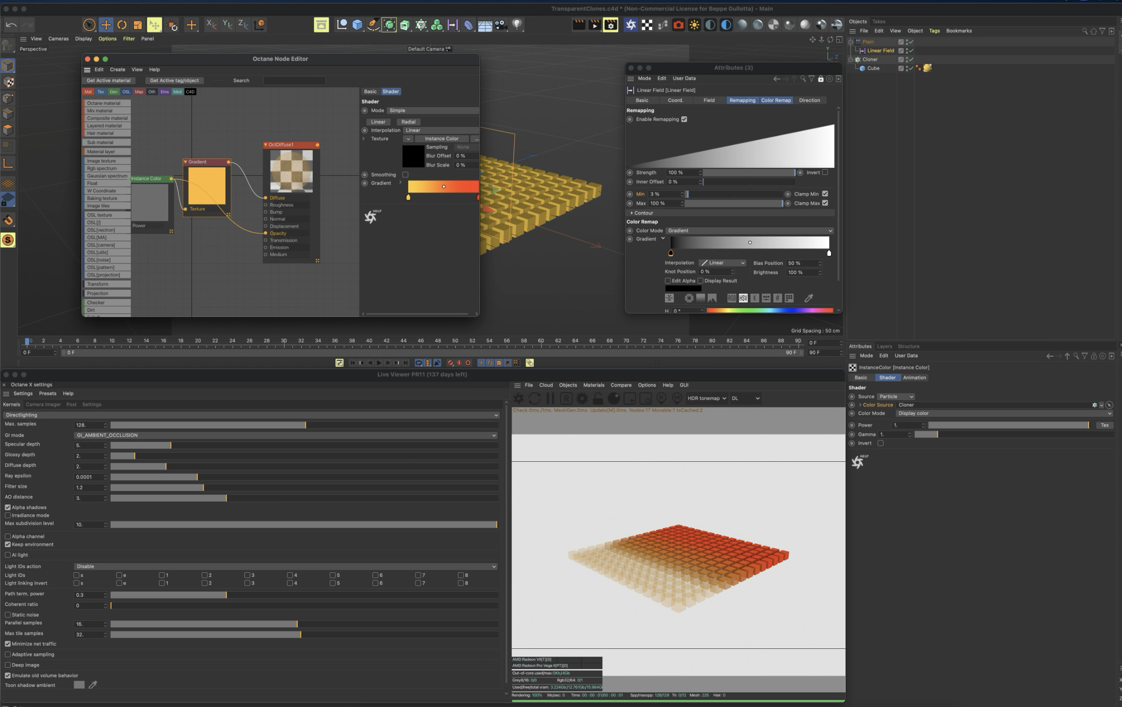

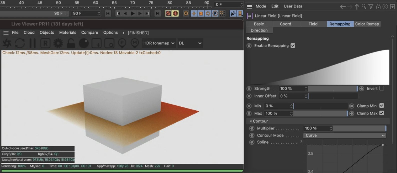

you can use the InstanceColor node, with the Cloner as source, and using Fields for coloring the cloners:
TransparentClones.c4d.zip
(63.88 KiB) Downloaded 192 times
ciao Beppe

Thanks man, this is brilliant, Instance Color is really a good feature that I overlooked it. But friend, there is one problem I cannot solve regarding this situation: the transparency doesn't reach absolute zero, it seems it acts step by step and is not smooth like a real 3d-linear gradient. Do you have any solution for this as well? Milan's result was very smooth but it seemed so tricky and hard to use in a scene when you wanna easily apply a 3d transparency gradient to bunch of different cloners in the scene.
Posts: 10598
with this method, you define a transparency color per instance, so the smoothness depends on the number/density of the instances:

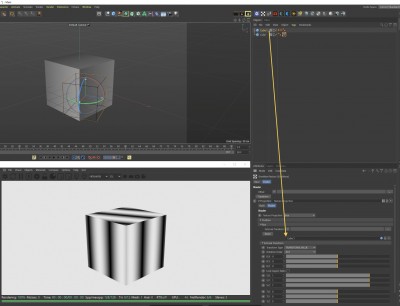

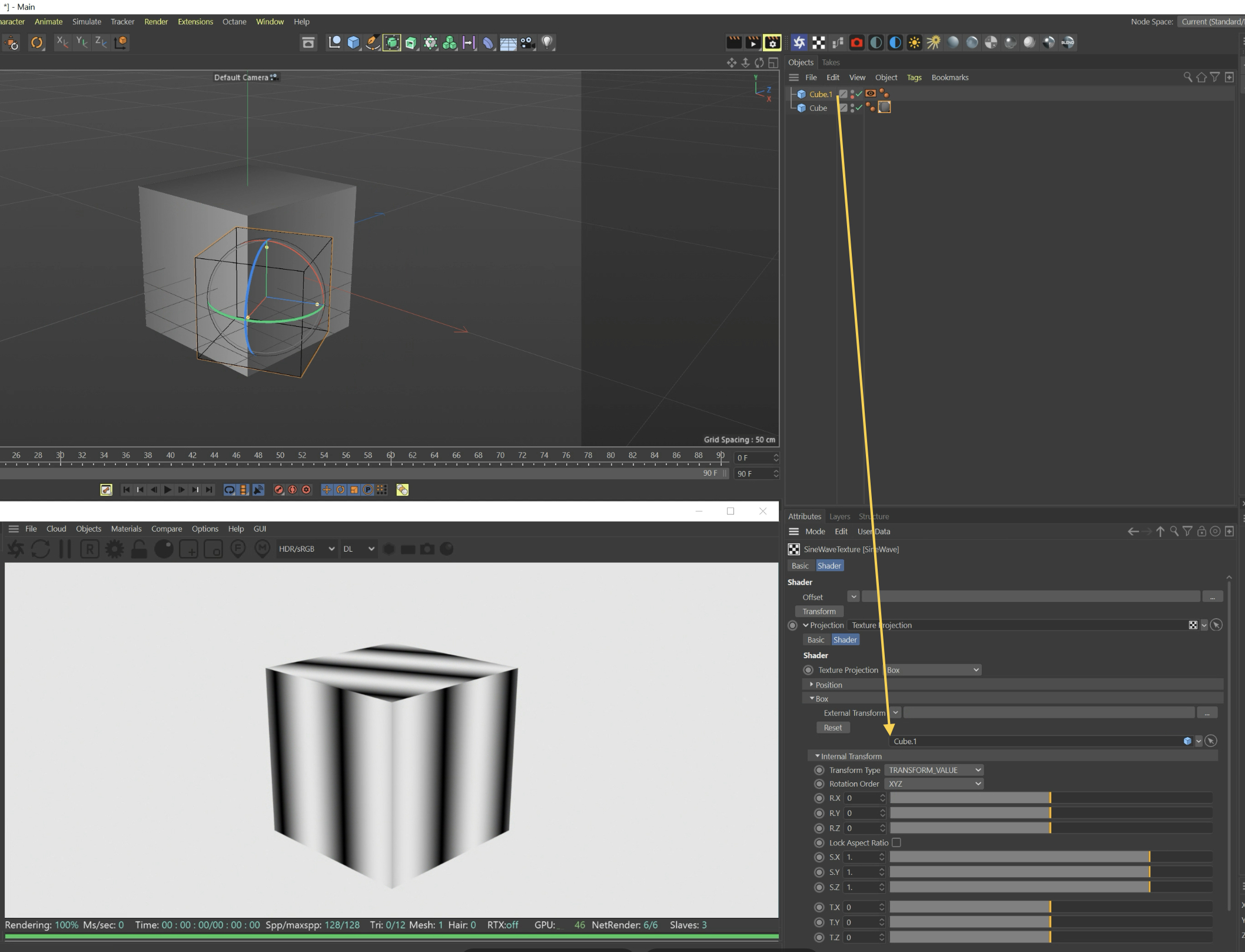

Yes, you can use an Octane Gradient node, with SinWave as texture, and use a Projection like Box or Planar/XYZ to UVW, with Position in World Space:
ciao Beppe

SinWave node is the real Gradient in Octane, and it works in 3D space. It has two other modes (Triangle, and SawWave), and you can use an object in projection to control the position/rotation in viewport precisely:
On the other side, the Octane Gradient node should be called Colorizer, compared with C4D shaders, it needs a Texture in the input pin to work.
