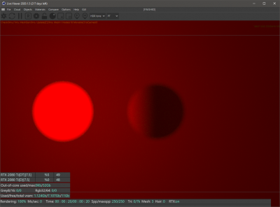

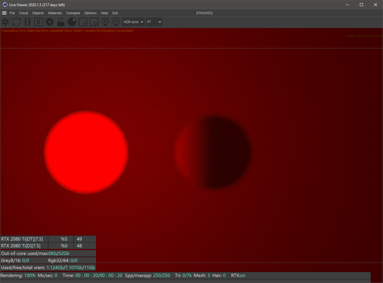

It is actually working, but you have Auto focus enable. If you disable auto focus, you can clearly see the emission sphere is reacting as expected.
Even with Autofocus enabled, it is still working. You can demonstrate that by decreasing the power and watching the edges of the emission sphere get less defined, matching the other sphere. This is easier to see if you increase the resolution of the spheres. The emission sphere appears to be in focus after you get past a certain brightness level.
FYI, it is better to use a gaussian spectrum node for emissions. You will get more control and a cleaner result more quickly.
Here is a snapshot of the Live Viewer showing the result:

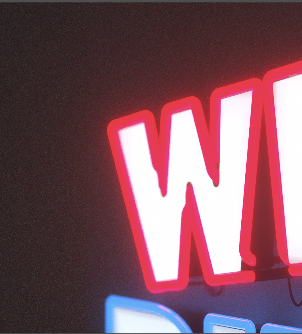

In the original scene the autofocus is off. But as you already said it gets "in focus" past a certain brightness level. This is unfortunate because I am trying to light a scene with it.
I attached a screenshot which might show the problem a little better. When I want to light up the wall behind the neon sign it needs to have a certain power which leads to the unwanted focus unless I turn the f-stop on the camera down unrealistically high.
Any ideas?

if the luminance difference between background and emissive pixel is too high, you can have anti-aliasing issues, and you should have to increase the Filter size in the kernel to remove it, but in this way, it is blurring the entire image, or reduce the Emission Power, to reduce the contrast, and avoid the anti-aliasing effect.
Please have a look at this other discussion on complex emission:
viewtopic.php?f=30&t=67076&p=337289&hil ... se#p337289
In this wasy, you can save a lot of rendering time, and you have a better control on the visible part of the emissive object.
ciao Beppe
