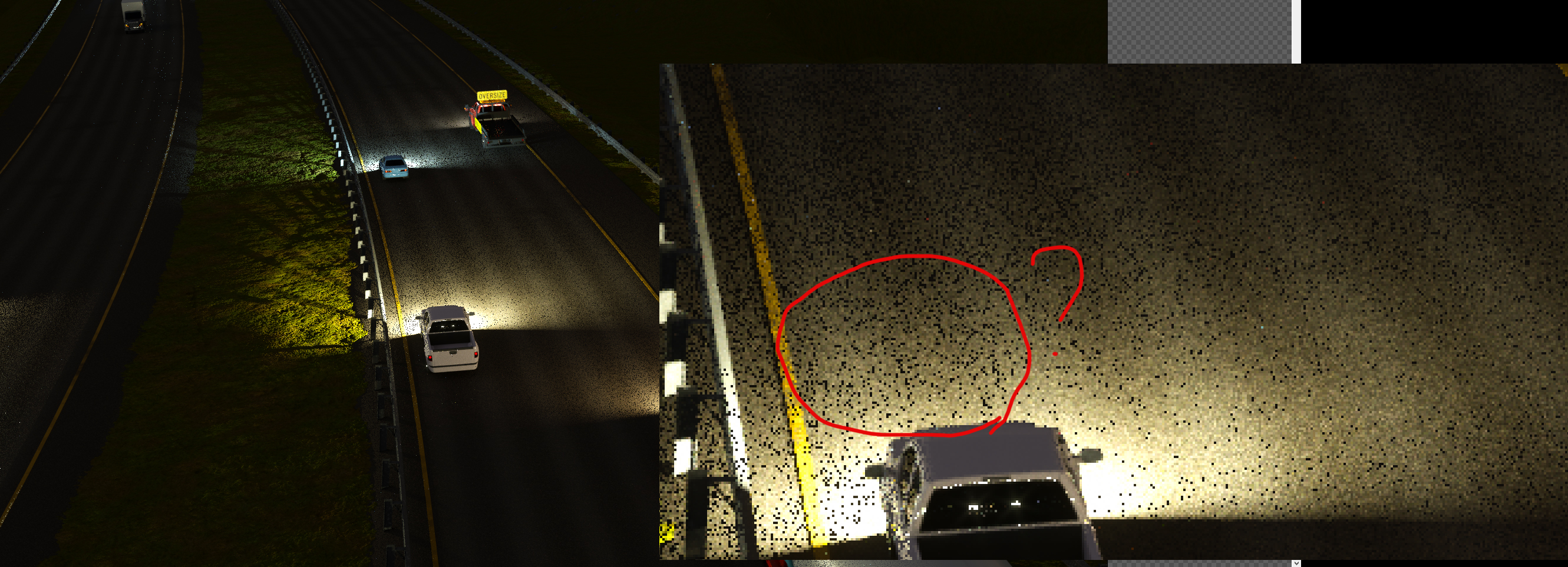

Why is octane so bad with night scenes that have lights. No matter how long I render I still have noise and black pixels.
Can this be fixed?
I tried messing with sampling nothing works. Is octane just not good at lots of lights at night? Thanks
The image attached is after 50k samples
I wish devs remove sampling rate or make a new way for nights scenes with lots of lights. It's the biggest pain. What if you have 100s of lights and tweaking all these rates is a nightmare. (At least add a global parameter - reset all lightsampling rates to 1)
Also reflection of lights in specular textures especially with DOF is the worst. Pure noise. Honestly octane has the worst quality when it comes down to multiple lights at night or light reflection with DOF

What works for me, but I`m not doing night animations often:
- caustic blur - 1
- GI clamp to around 2000 or less (check to see the difference with say 100)
- Enabling AI light + denoiser
- Making sure adaptive sampling isn`t messing anything up (expected exposure should be correct)
- Never have 0 roughness or full white material
- Specular materials with 'fake shadows'.
- I always put sampling rate up to max
But most of the time the GI clamp does work wonders!
Greets

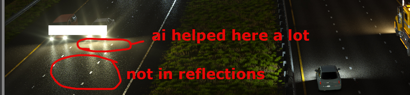

Thank you! AI light did help. Unfortunately we use AO so no GI otherwise render times will be so much higher
Light and reflections for octane is still a tough problem to solve on a large scale

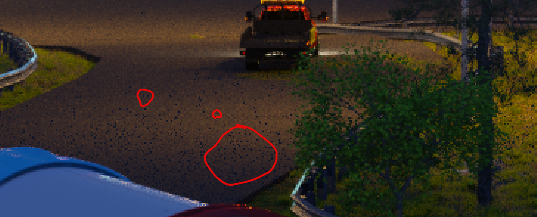

I tried it doesn't work much. Do you know by any chance why there are pure black pixels like in the iamge above or the one I attached? is it missing data? It was rendering for 50,000 samples
UPDATE:
I noticed it happens a lot when two or more lights shine at the same point (surface)

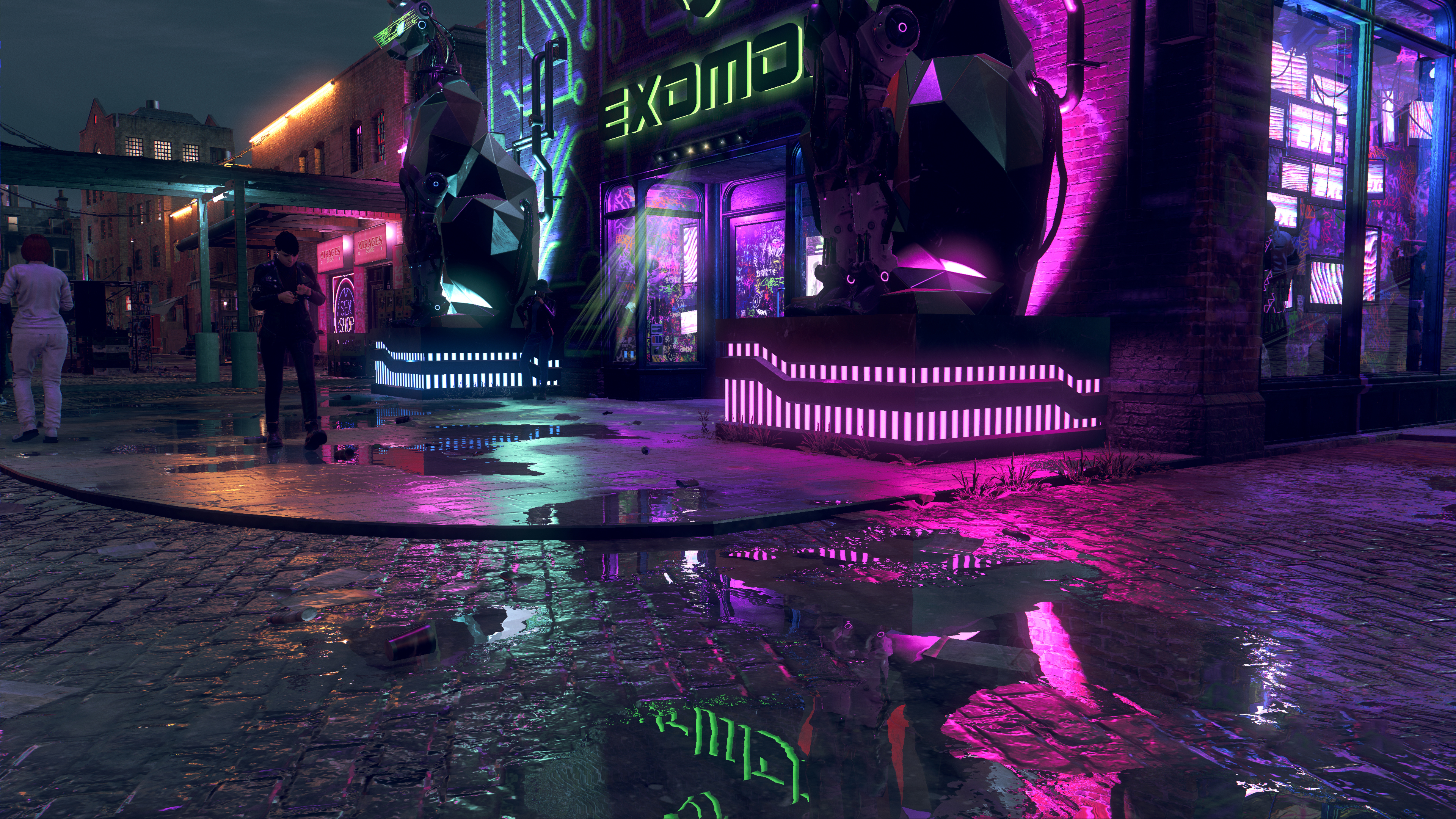

What i dont get is how games use unbaked realtime RTX light (like this Cyberpunk game) noise free and we render for 2-3 min with tons of GPUs to get noisy light from frame to frame just because i have 20-30 lights in the scene .
