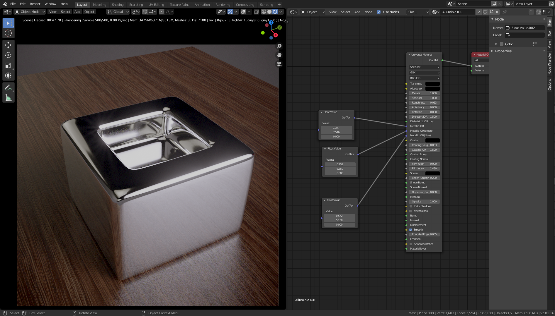

I'm studying how to implement in the physical correct way the metal materials in Octane for Blender, but unlucky there's not so much documentation of the official online guide about it.
I've tried to follow the official guide about Octane for C4D on YouTube. In C4D there's a field for the K and N value that you can find at this page: https://refractiveindex.info/ (Look from the Shelf - 3d selected data for Artists)

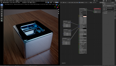

In Octane for Blender, in the Universal Material, we have three slots for Metallic IOR, Metallic IOR (green) and Metallic IOR (Blue). What are the X, Y, Z values refer to? I've supposed the X was the wave length, Y the n value and Z the k value. Unlucky, when trying to fill the date in this way, I not get the correct results on how I was supposed.
Example 1
Copper IOR
Copper IOR
Here I've tried to create a Copper Material using the values from the refractiveIndex.info and the supposition of X,Y.Z like I've written above. It turned out like a sort of blue metal.

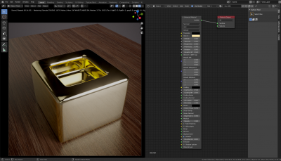

Example 2
Gold IOR
Gold IOR
Here I've tried to create a Gold material. If I use all the three fields of IOR, I was getting again a blue kind of metal. Using only the IOR blue value I got a sort of weak Gold color.

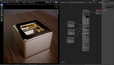

Example 3
Gold HEX color
Gold HEX color
Here I've used the "Default" selection on the universal material node and used a HEX color value on the Albedo color. The HEX color I got from this post on Chaos Group Blog where they talk about Metalness workflow and there's a table of RGB / HEX values for Metals: https://www.chaosgroup.com/blog/understanding-metalness
At this point, I would like just to know how to use in the right way the IOR of the metal in Octane for Blender to get a good (and physically correct) metal material.

Thanks for the reply and to point me out about the guide for the Octane Standalone. I am referring myself more on the C4D guide that I found more detail in the explanations compared to the Blender one...
So reading the information from the guide above I've supposed it almost correctly. And I've set already my material to RGB IOR. At this point is just to understand what the X,Y,Z value stand for. I suppose the X isn't for the wave length since it's given that the first slot is for the red 650nm, the second for the green 550nm and the third for blue 450nm. In the refractiveindex.info I find only the values of "N" and "K", I miss the "i" that is written in the above formula (n-k*i)

axelts
Posts: 12
Joined: Fri Jun 04, 2010 8:59 am
grimm wrote:You don't need to worry about i, it's for the incident ray. N and K are needed though and I noticed that the Blender plugin is missing the two fields for this, unlike stand alone. Probably a bug, you should put a report for it. You might try to subtract K from N and put that value in the fields?

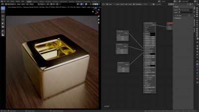

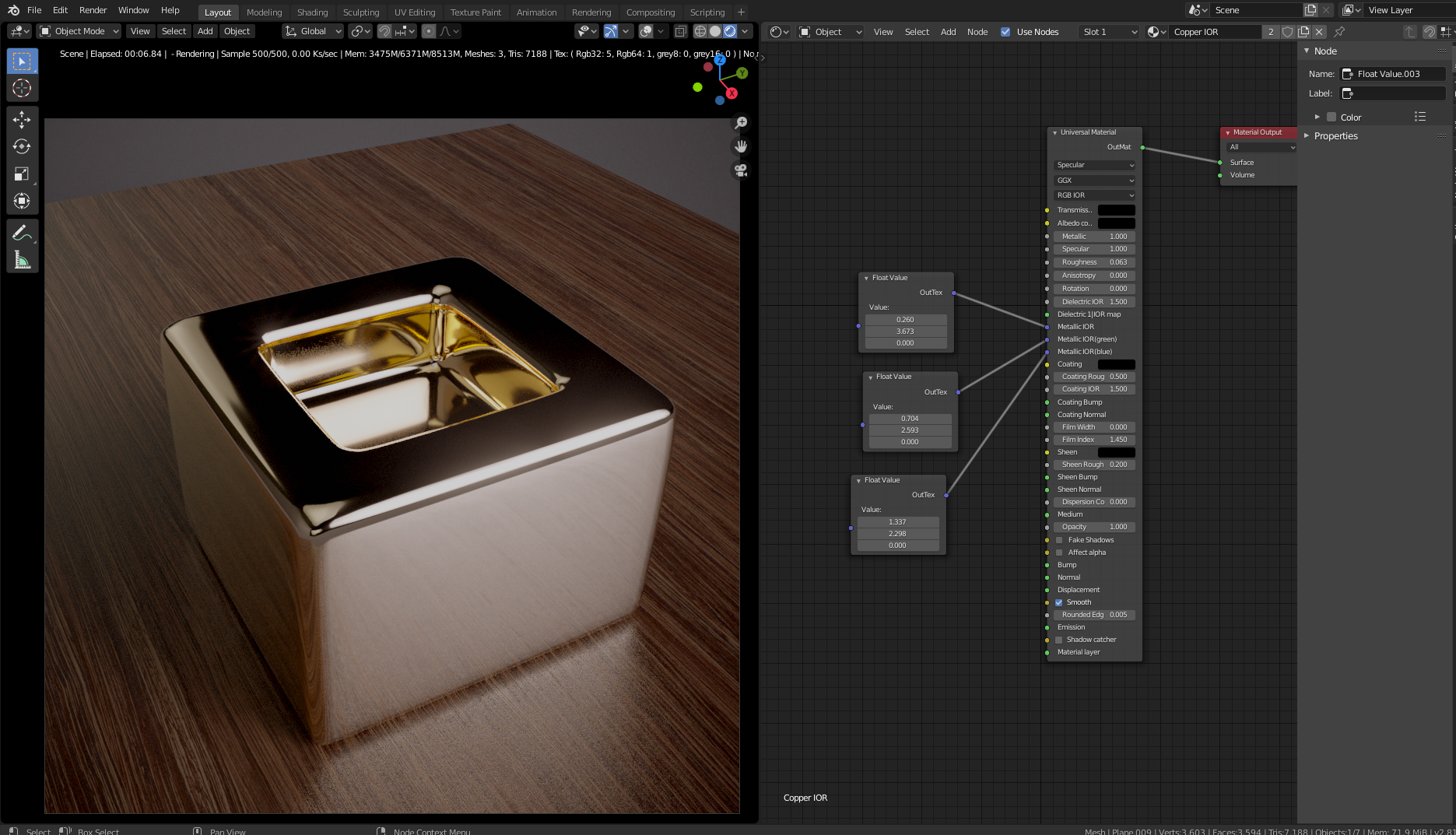

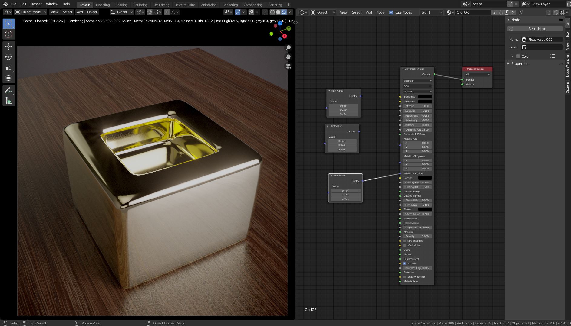

Ok, I've figured out doing some tests now: X value is for "N", Y value is for "K" and Z can stay just "0".
In this way the materials works perfectly:
Gold
Gold IOR correct
Gold IOR correct
Silver
Silver IOR correct
Silver IOR correct
Copper
Copper IOR correct
Copper IOR correct
