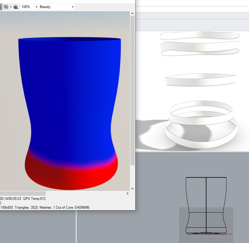

no problem, here you see that the texture placement is correct in the Rhino viewport but not in the Octane Render Viewport.
Hope that helps.

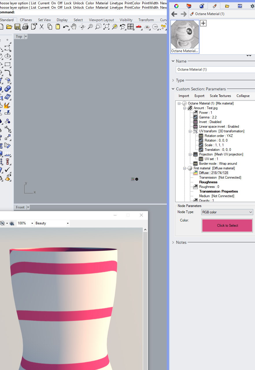

Hi Nando - the Mix Material "Amount" pin needs the Projection set to "Mesh UV Projection" in order to use the mesh UV's.
Paul
Refracty
Posts: 1599
Joined: Wed Dec 01, 2010 6:42 pm
Location: 3D-Visualisierung Köln
Hi Paul,
you are right, the projection hasn't been set to Mesh UVs.
I am very sure that I didn't change anything on that afer creation and thought it must be always default.
That is strange but it seems to work correctly.
