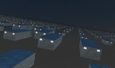

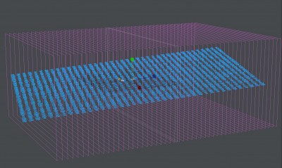

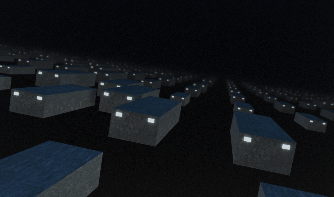

Since I really hate octane fog options (I never seem to get it right), I went looking in a fake fog direction. Well, maybe this is an option. This was created using instanced planes with all 99% (or whatever you like) transmission.
At least I can control the depth of my fog better and for you guys I hope we can improve this thing in total... cause again, octane fog just doesn't deliver
Like to hear your thoughts on this.
fake fog solution

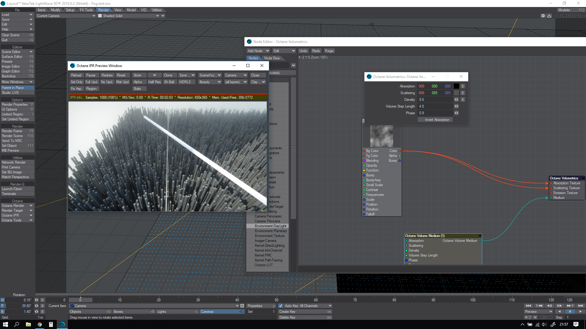

2 years earlier
btw you can define the color and also the tint from the "z-depth" with the input channels from the medium or volume scattering node "absorbtion" and also "scattering"...take as input for example a color gradient bitmap or build something like that procedural or with colored gradients nodes...you have all possibilities!
