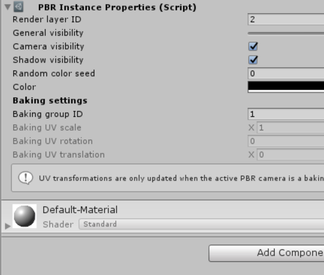

You can do this by following these steps
1. Select Mesh Object in unity.
2. Go to PBR Instance Properties in the inspector
3. Set Render Layer ID to 2 4. Select to the active rendertarget

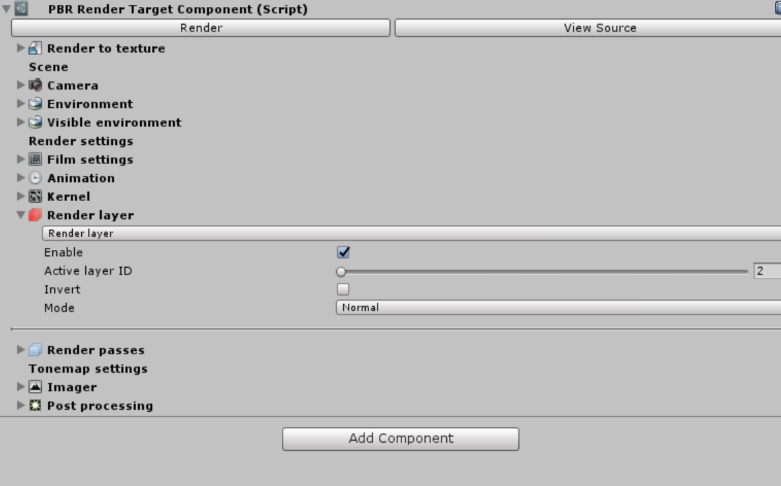

5. Go to "Render layer" in the rendertarget settings
6. Enable, and set Active Layer ID to 2 *Setting mode to "hide from camera" seems to be the fastest
