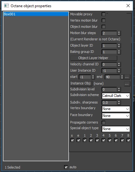

Is the Octane Object properties accessible through maxscript?
I mean like turning movableproxy on and off, and changing the Object layer ID using maxscript.
I can use the "showproperties" function to expose the Octane render settings.
But i haven't found a way to expose the Octane object properties.

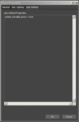

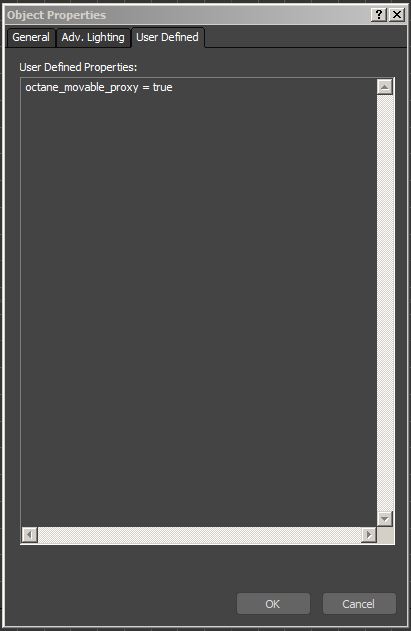

Check for an object "movable proxy" in octane object properties , then open object properties, and you can see in user properties what it is writen.
