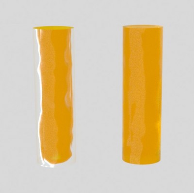

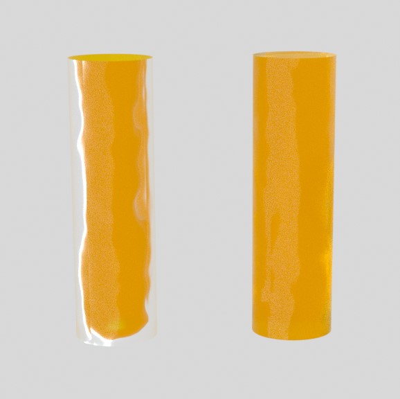

Hello,
I`ve got a question for material settings.
As you can see in the attached image, the left object is a Loft-Nurbs with the same Material uplied as the right Zylinder. But the Material on the Loft-Nurbs looks different on the Edges. Why? I don`t want have these extrem opacitiy on the Edges. I`ve attaches also the C4D file.
Thank you
Best regards

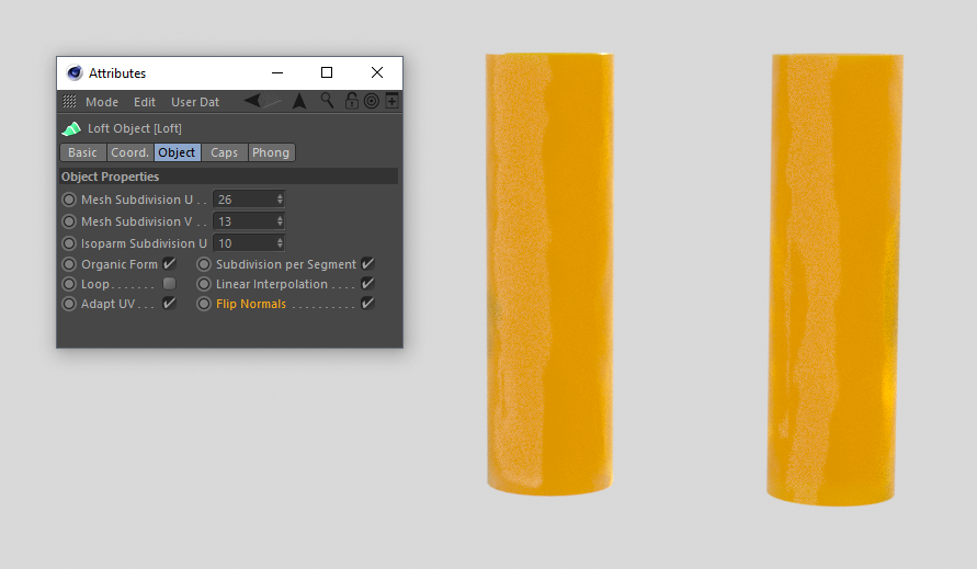

I think it's because your normals are facing inwards rather than outwards.
The loft object has a "Flip Normals" option, which should fix it. Alternatively, you can rotate the circle splines 180 degrees.

I love these simple solutions that you do not think about :-)
Thank you very much!!
