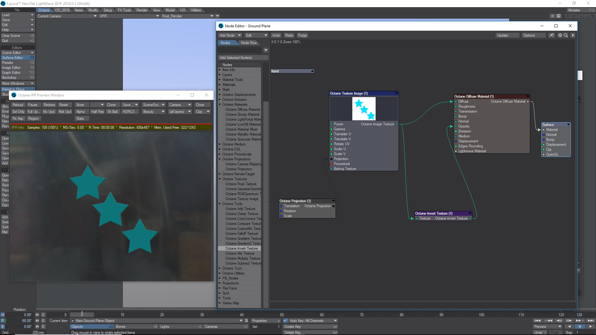

I am not sure what you mean by simple scene and complex scene as that is subject to interpretation. But can you attach the image because I had some time to test where I made a simple three layer PSD with simple star shape duplicated and moved to show each of the three stars. I loaded into Lightwave using the geometry tool to create 1mx1m plane. In sufaces, I add the Octane Texture node and projection because the Layout geometry tool does not create an UV, and then mapped the texture to a Octane diffuse node. I then added a octane invert texture tool and mapped the same image to it's input and I mapped its output to the octane diffuse opacity input. If you map it directly the alpha is inverted.
Looks perfect in Octane IPR so I am not sure why yours does not work.
I am attaching my simple start PSD image and a screen shot in hopes it helps
