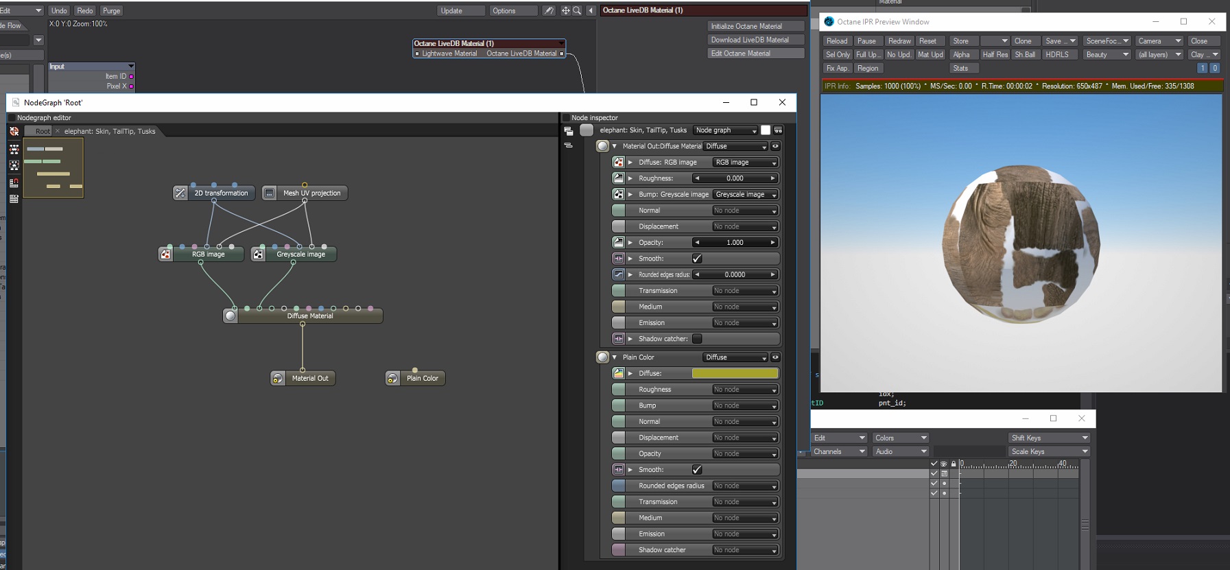

I've just fixed a bug in the LiveDB/LocalDB feature related to all the imported texture maps paths, that were broken due to a change in the SDK. With this fix I can import your material without problems so far, as you can see in the attached image.
I'll release a new plugin build along this week with this fix.
Thanks for reporting it!
