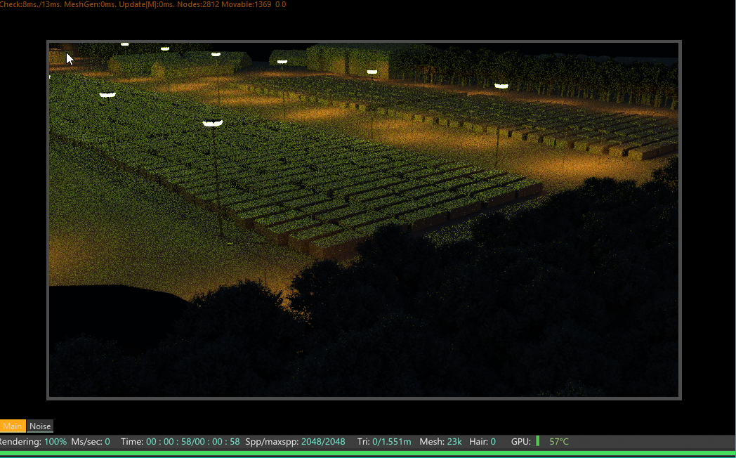

I've placed several light sources in my area but the light takes forever to clean up and the spill is kinda weird.
Any pointers?

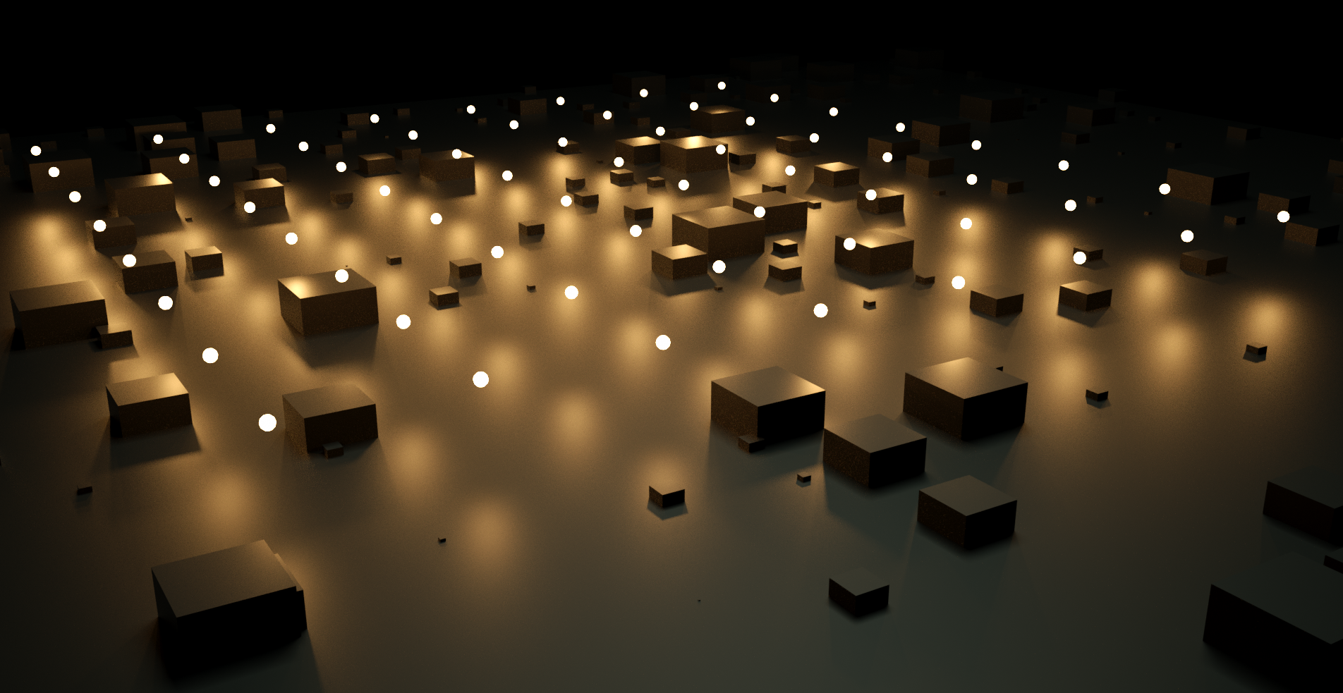

The smaller the lights, the noiser and harder it is to render. Increase the size of your lights to something that you would expect to be a bit bigger than the light source.
You can hide those lights from your camera using an Octane Object tag. Then you can add smaller ones that aren't very bright that just act as light geometry in your scene. There are a few ways to do this in compositing as well that may save time on your rendering. Just gotta be clever with it.

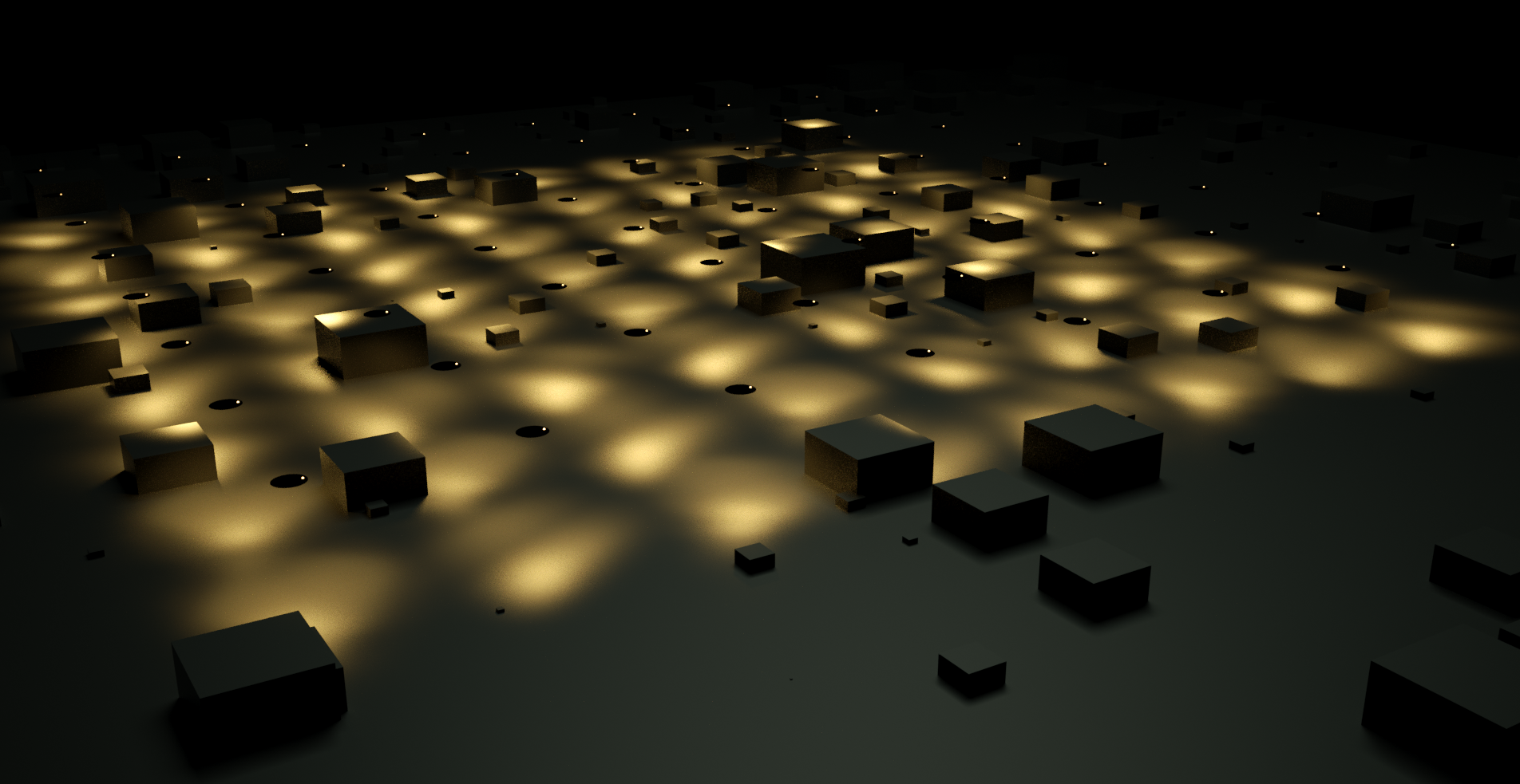

The above example used spheres but real lights are generally cast in a specific direction. To get realistic light casting for things like bulbs, you will want to use IES lights. Cinema comes with a huge selection of them in your content browser. Just search for .ies in your content browser. It gives you a really nice, nonuniform light spill on the ground.

Thanks for the tips and scene file mate. Definitely helped, but cleaning up the lights still takes quite a long time.
Gonna find some ways to overcome this.
