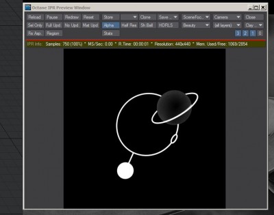

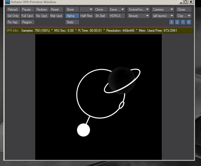

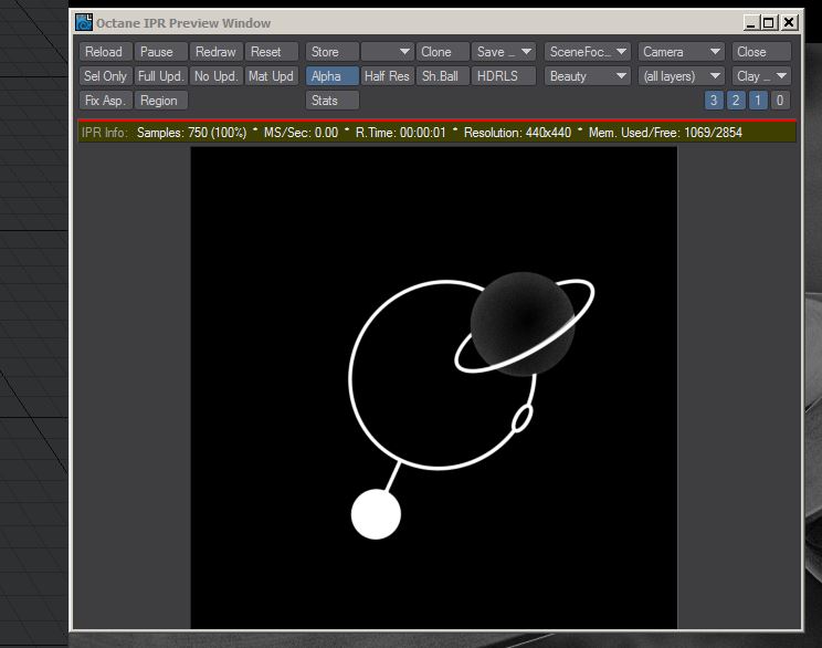

Hi Juanjo,
I'm using the latest build and want to use a matte object to occlude the alpha channel.
I apply it to an object, but a ghost of the object remains in the alpha (see below).
I thought the matte object would leave no trace in the alpha channel, or have I got it wrong?
Thanks,
Carlo
Thanks,
Carlo
Ryzen 5800x at 4.4GHz | 32GB | 1 x 3090 ti | 1 x RTX 2080 ti
Are you talking about the "Matte" option available in the diffuse material? Probably this parameter should have been renamed as "Shadow catcher" a long time ago, because this is how it works.

Yes, exactly.
For comping, it would be helluva useful to have a switch in the Diffuse material that one could switch on and the object would be 'cut' out of the alpha channel.
The matte object switch is 99% there, it's a far faster work-flow than going into layers.
