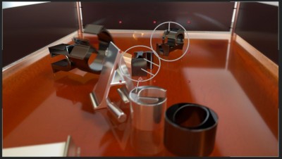

I was having some strange issues as well. A simple animation created with bullet, and then baked with mdd's. Surfaces would randomly seem to disappear or look like they had some type of clip map applied to them when they rendered normally the previous frame.
After reading FrankPooleFloating's post, I lowered the ray epsilon incrementally from 100 um to .05 um, and the artifacts disappeared. Is this normal?

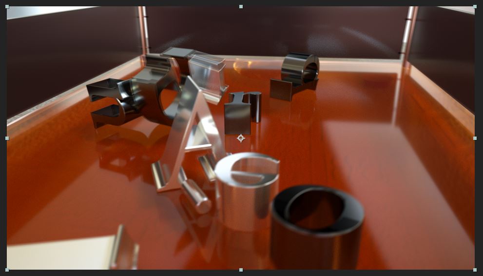

Well, the ray epsilon setting I thought was the solution turned out not to be. While the artifacts I was seeing like clipped geometry went away, I started seeing the concentric circles in the glass and the image got noticeably darker. Looking for another solution. I've tried tripling the n-gons and also the quads, because the artifacts are showing up on both. No cloned objects, but a mdd reader on the object deform panel.
