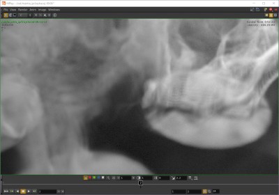

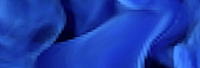

i've been using TFD for a few days now and i come to a strange
bug in renders, there are some kind of a grid appearing,
more obvious on some parts of the image, i took a screen capture to show you:
These strange artifacts doesn't show up with regular VDB renders,
only with TFD.
Do you have any idea what could occur?
Reducing volume steps helps a little bit but needs insane render times,
and VDB renders never shows these artifacts, even at very low resolutions.

It seems a low grid resolution issue. Do you know if a VDB file from the same TFD cache has better resolution? Perhaps the internal Octane VDB processing supports some kind of interpolation not available exporting the grids directly from TFD.

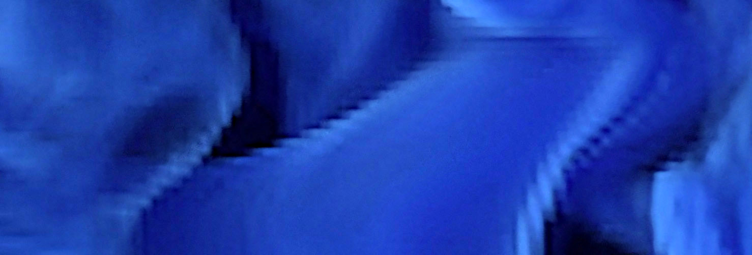

i made a few more tests, sadly the VDB file has the same issue,
and uprising the resolution of the render (i made a test at 6400*4800 pixels)
gave even worse results...
When looking closely to the preview of the TFD smoke in the layout view,
you can see this grid showing up, but not on regular LW renders.

Anyway, I know that TFD has tools to smooth and add detail to the base grid at render time, a feature not available yet in Octane. I suppose that this is the difference that you can see in the Octane renders. I suppose that the only workaround is to work with more dense grids.

i did another test with a denser grid,
it stills shows up but as it's smaller
it's not so obvious at rendertime.

Other render engines have better voxel interpolation techniques to avoid these artifacts. For example the same VDB file rendered in Houdini with Mantra looks a lot better, but the grid artifacts are still there. Probably the GPU path tracers are not so good for this kind of grid interpolation algorithms.
