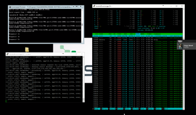

YES!!! It is working...
Here is a command line eye candy shot:
I will try to add the:
--alias "%COMPUTERNAME%"
to the end of my linux command.
Actually I am not using a script on the Linux slave because it did not seem to work properly. I am running this string on the Linux slave:
sudo ./octane_slave --net-master-address 10.0.0.185 --net-master-port 1025
