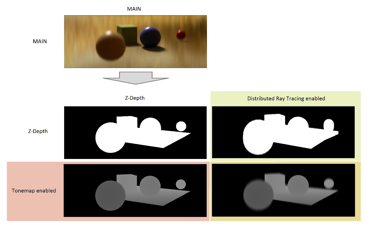

Hi BLKRCAT,
look at the attached image:
here is the link at the Standalone documentation about info passes:
https://docs.otoy.com/manuals/products/ ... fo-passes/
ciao beppe

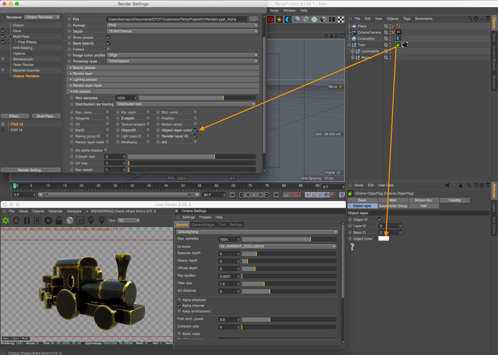

Posts: 10615
Hi BLKRCAT,
please look at the attached scene, I have removed the Render layer mask, and acrtivated the Object Layer Color pass in the InfoChannel section. With a Object Tag, it is possible to define the desired color for each part that needs a specific mask.
I have also increased the sampling in the info channel section at 1024, with DOF it is necessary to cook a bit more, in general.
TempProject_b.c4d.zip
(710.78 KiB) Downloaded 373 times
Happy rendering,
ciao beppe

Posts: 10615
Hi BLKRCAT,
by default, everything in the scene is in the Object layer 1, so in general, if you want to isolate an object, you assign an Octane Object tag with an object layer greater than 1.
Happy rendering,
