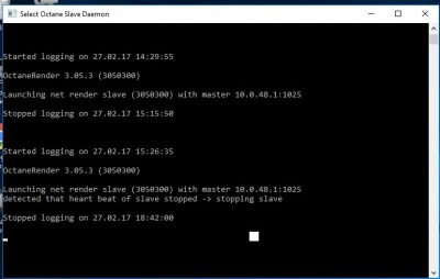

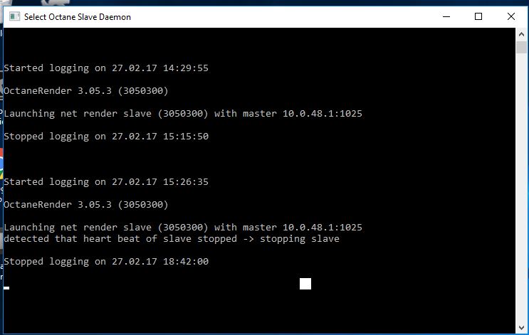

One other issue, I set up a render to run overnight using this new remote server we have, and it shut down about an hour after I left the office. I'm attaching a screen grab of the slave dameon window that was on screen when I came in this morning. Any idea on what may have caused this? I'm going to try to run another test tonight.
I was using a PMC render kernal before, and when I switched to direct lighting to test those settings you mentioned, the remote GPU's are running a steady 90-98% performance load, and after tweeking the direct lighting settings to get the the image quality I had before, I have my render times down to under 3 minutes a frame.

Main causes of network failure are as follows:
1.- Overheating on the GPUS. try MSI afterburner to tweeak performance Vs Temperature. IF you have Watercooling, the performance improovement is dramatic.
2.- Using to much Vram, creates Cuda Errors.
Other alternative is that you have a bottleneck on your network, we have the Slaves connected directly to the main CPU via a standard Switch, but no other network trafic, no internet.
Possible issues with motherboard not handling well the IO of four GPUS in one box. Motherboards are very strange in that regard.
