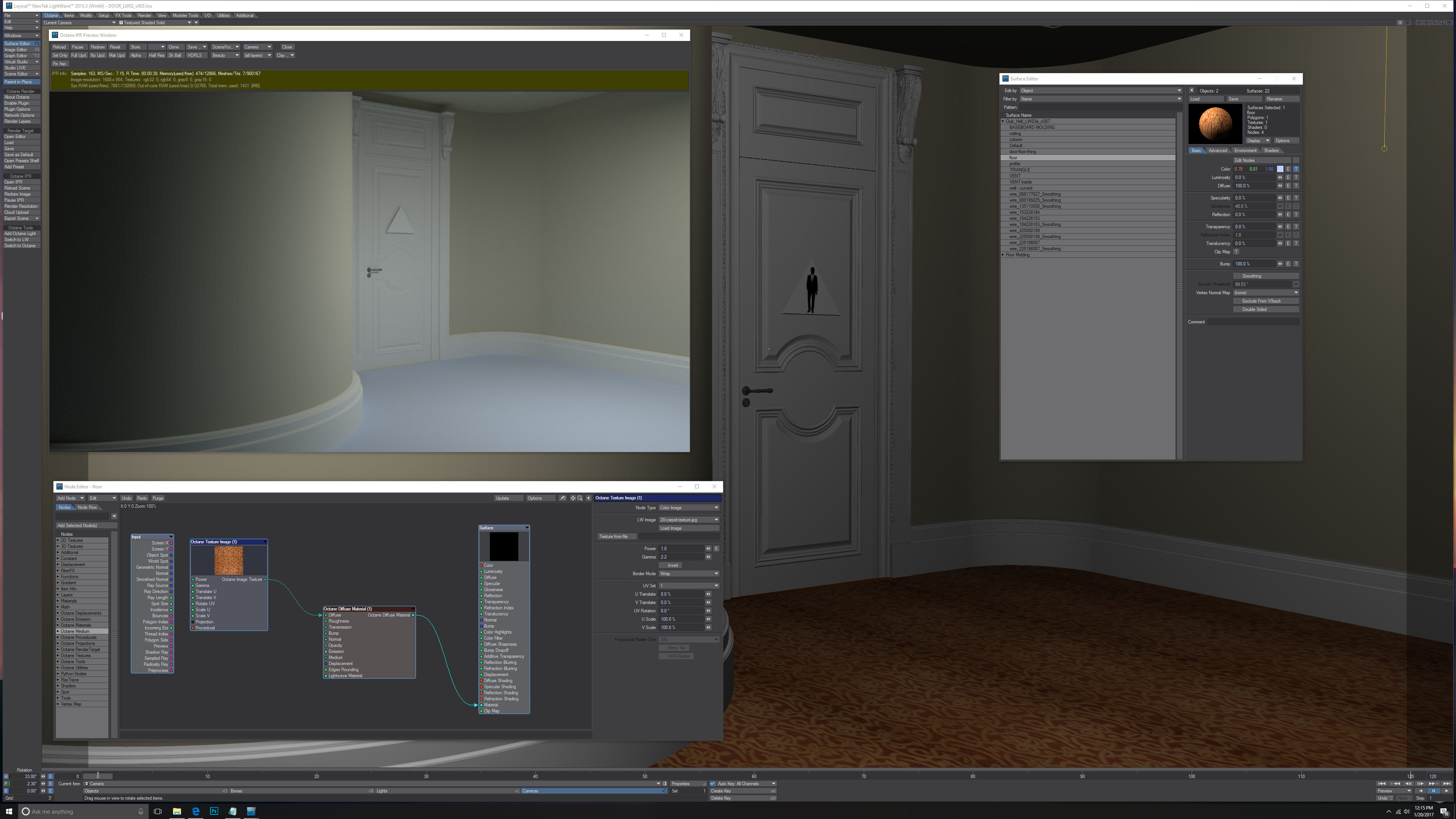

I'm trying to add an image texture to the floor of my scene but it's not showing up in the preview window.
How do I do this?
Here's my scene:

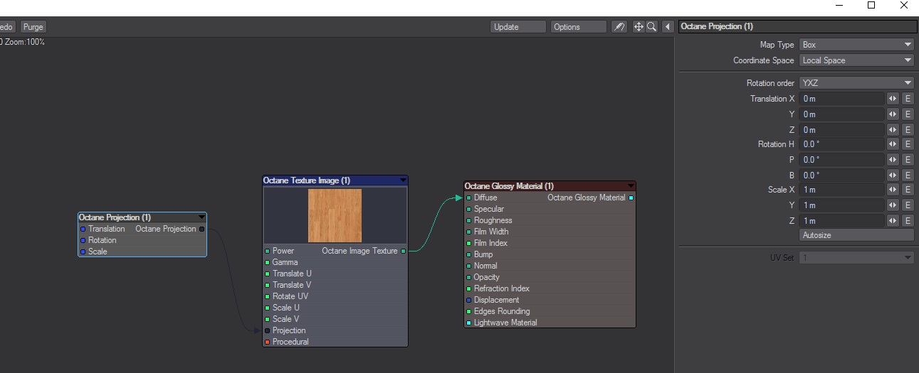

If your object doesn't have a UV map, you need to use the texture projection node to set the projection to be used.

Also, you don't appear to have the Enable Texture Node box checked. It is just to the right of the Edit Nodes button.
