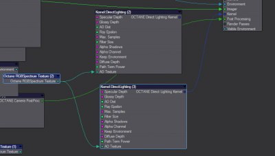

AO Texture input does not reset when it is disconnected, it should behave the old way again.
If there are two direct kernels the AO Texture input of the second one does not work, it is ignored.

BorisGoreta wrote: AO Texture input does not reset when it is disconnected, it should behave the old way again.
[/attachment]
Thanks Boris, I'll check these issues for the next build.

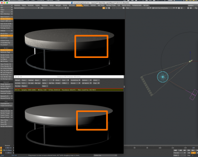

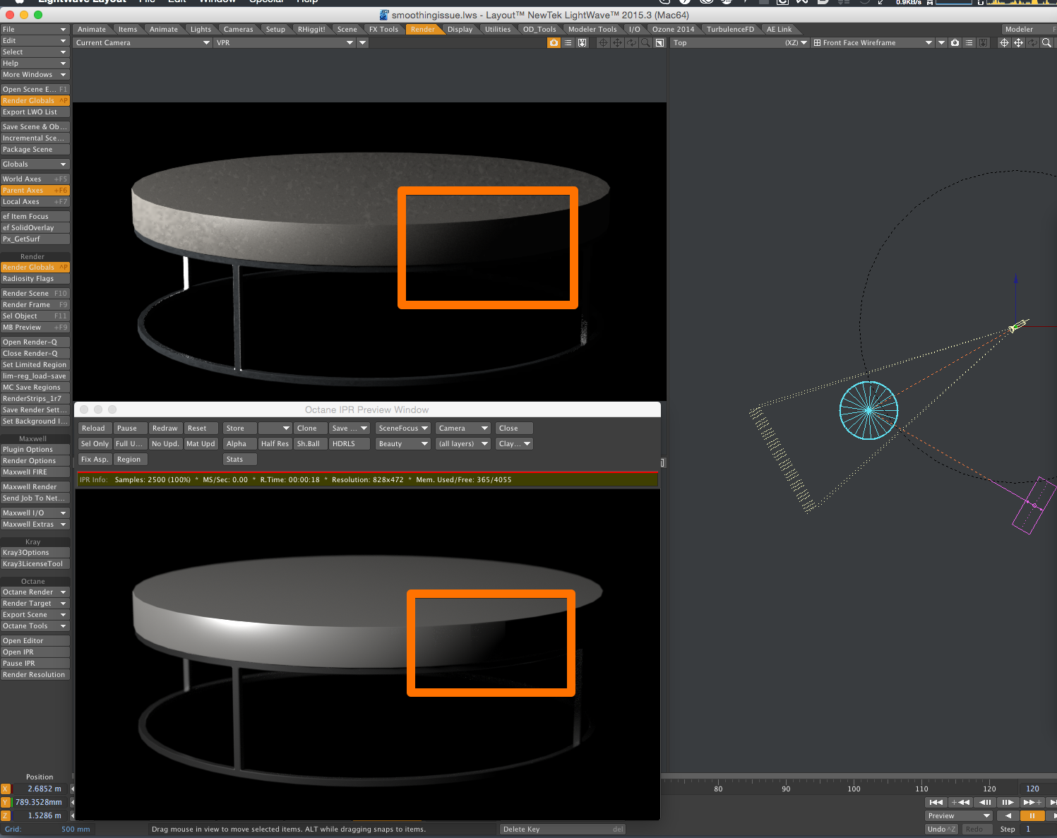

great new build, but i am experiencing some smoothing issues never seen before, not sure if it started with the last build. anyone else having this?
EDIT, sorry a bit hard to see because of image compression, but on the screen you can clearly see the quads of the model being unsmoothed near terminator in IPR, which does not happen in VPR. it's a mixed material diffuse + glossy and both nodes are set to smooth, no edges rounding.
EDIT2 actually, in the first screenshot - which i added now - you cane see the artifact better!
