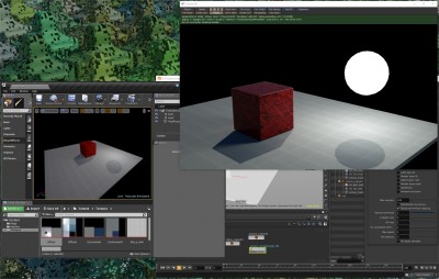

Alright, after reading the Photoshop Plugin docs and messing with the "Setup OctaneRender Render Layers" script I've got a matching result. I think this will be enough info to figure out the rest of the pipeline. Thanks for responsiveness once again!
limeforce
Posts: 62
Joined: Sun Dec 21, 2014 7:53 am
Yay! :) At some point I'll figure out rounded edge baking too, now I need some sleep.
