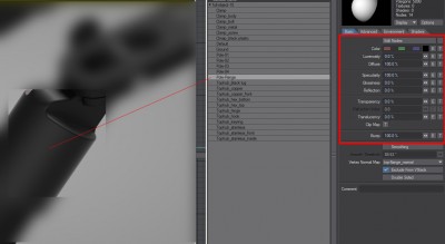

When the nodes are not activated the surface renders as in the attached file, but I can't seem to replicate the look inside the Octane node system.

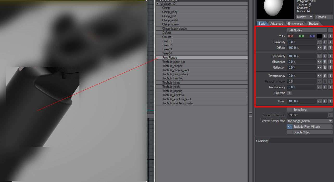

In the attachment Octane is rendering a material in the IPR -- if you look at the material the node is not activated.
So my question is what settings are being used to render this material? Is there a formula that Octane uses to convert the LW material to an Octane material?

So given the settings in the LW material (outlined in red), do you know what the corresponding node settings would be in Octane (that are being extracted from the LW material)?
I want to base a texture off this material, and can't seem to recreate the look.

Using a Glossy material node, you should be damn close with settings similar to this: Diffuse color of 0,0,0 -- Specular color of 10,10,10 -- Roughness around 50%
I see what you are trying to understand though, and have wondered myself; exactly what does Octane give a material, beyond Color, when nodes are not enabled... Default must have some glossiness, and some high roughness, like above. They never appear to be dead flat like Diffuse materials...
Win10Pro || GA-X99-SOC-Champion || i7 5820k w/ H60 || 32GB DDR4 || 3x EVGA RTX 2070 Super Hybrid || EVGA Supernova G2 1300W || Tt Core X9 || LightWave Plug (v4 for old gigs) || Blender E-Cycles
Yes, a Octane glossy material should be enough to simulate this kind of shading.
If you don't have any Octane material nodes connected, Octane builds a glossy material using the diffuse color, specular, roughness and transparency parameters of the LightWave surface editor.
