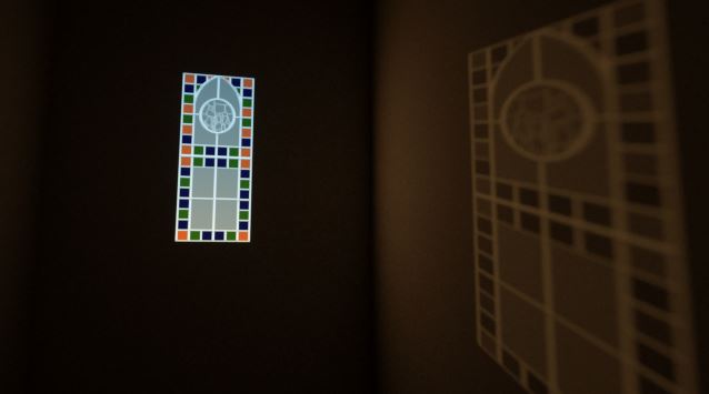

Maybe play with Gamma, on both?...
I'm not an expert on stained glass, but aren't they usually made with lead (Pb), holding all the glass pieces together, where your textures are currently lighter, and thus should be dark/opaque?
Win10Pro || GA-X99-SOC-Champion || i7 5820k w/ H60 || 32GB DDR4 || 3x EVGA RTX 2070 Super Hybrid || EVGA Supernova G2 1300W || Tt Core X9 || LightWave Plug (v4 for old gigs) || Blender E-Cycles
The stained glass effect can be done through the "fake shadows" checkbox in the window's texture image. This fake shadow effect can be influenced by the environment and lights in the scene.
See attached for an example. Fake shadows is also a good way to emulate the effect of Light changing color as it passes through surfaces without complicated setups.

Yes indeed, I hadn't got that far yetFrankPooleFloating wrote:Maybe play with Gamma, on both?...
I'll try using fake shadows to see if that will help. Thanks.
