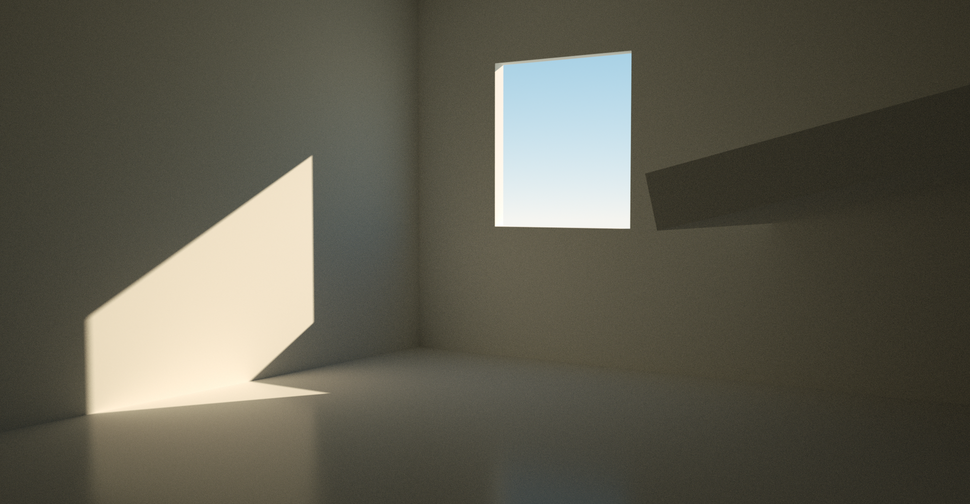

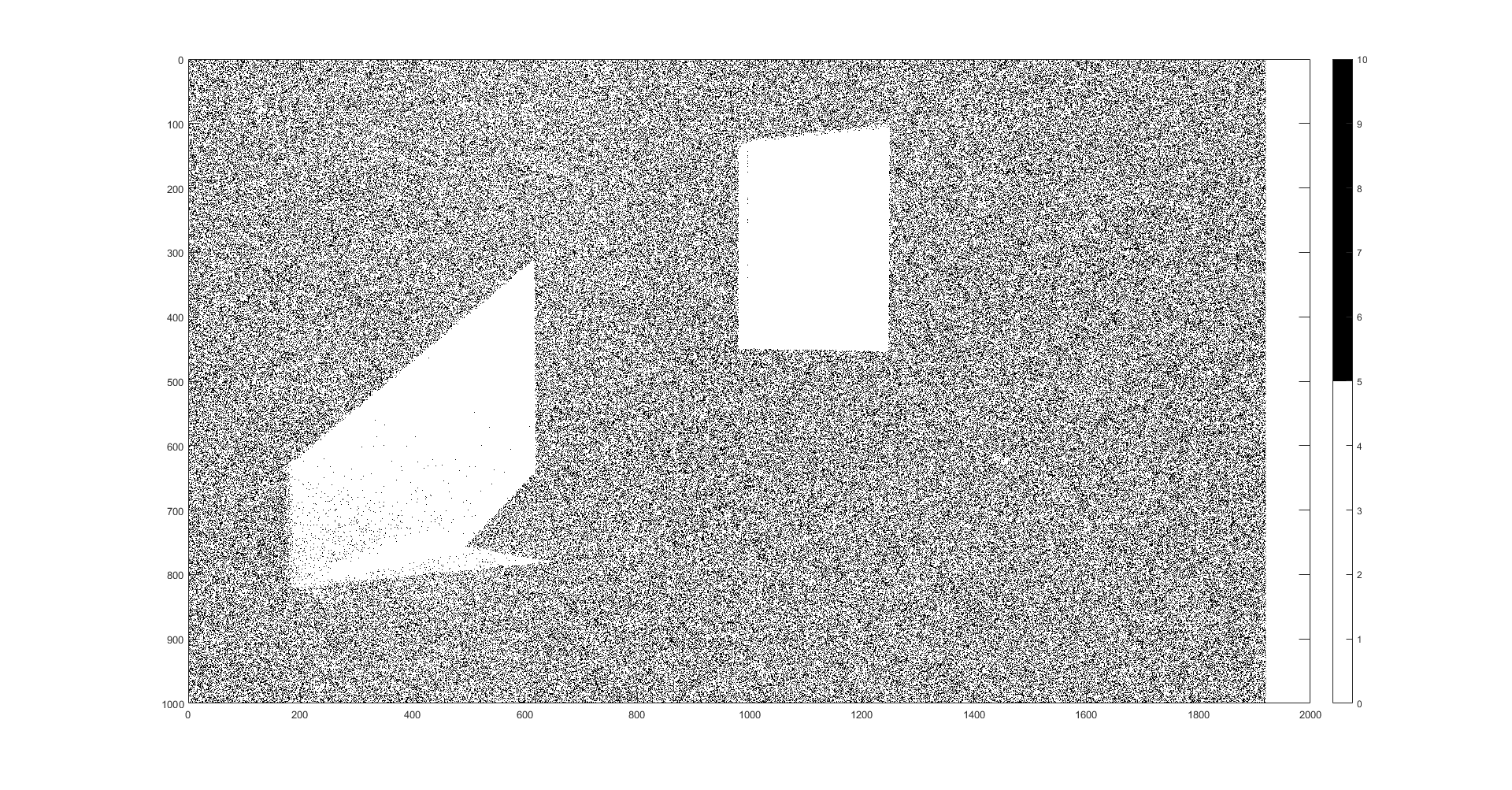

I am wondering if finding out which pixels are still noisy and calculating a relative "pixel noisiness" measure can help in optimizing the ray tracing engine (like progressively concentrating the rays on those noisy pixels/patches and reducing rays or even eliminating them for pixels that are already clean).
Honestly, I thought that this optimization strategy has been done long time ago until a saw a recent youtube of someone explaining the new features of an advanced unbiased renderer which includes a "manual way" for focusing rays on noisy areas. With today's advances in image/signal processing, I can't imagine a need to do this manually.
I've attached a simple test render I made with Octane (1000 SPP) with corresponding pixel noisiness level using a simple algorithm I developed in MATLAB (noise is dispersed so I just used a threshold to separate noisy pixels (black) from the one that are already clean (white)). Maybe Octane development team can look into using this technique if not already done in the engine.

OK, so can you post same graph for two different GI clamp values - 10000 and 1

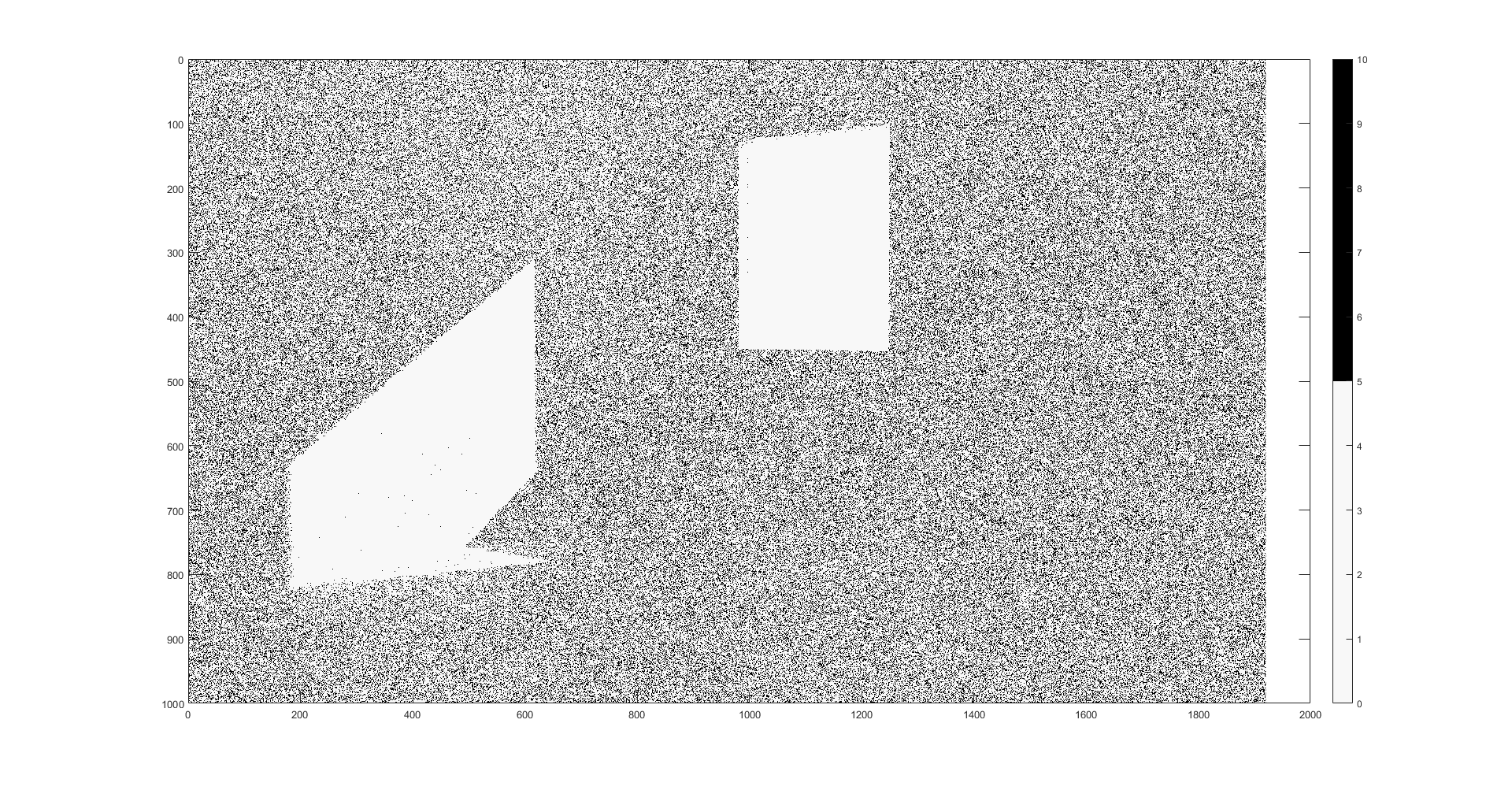

smicha wrote:OK, so can you post same graph for two different GI clamp values - 10000 and 1
Hi Smicha,
sorry I misunderstood your original request, still learning Octane render :).
Sure, I attached GI clamp of 1 and 10000 noise images. I changed the engine to PT and now working with 16 bit images. the noise distribution is different than DL, which is expected. the only clear difference at a glance is in the bright spot on the wall which still shows noise at 1000 SPP for GI clamp of 10000. there could be more hidden in the noisy regions but it is difficult to distinguish visually.

Thank you! This is even more interesting. So one more test would be useful: there is so called 'path term power' and it affects noise in shadowed areas. So could you run tests for 0, 0.5, 1 of its values?
