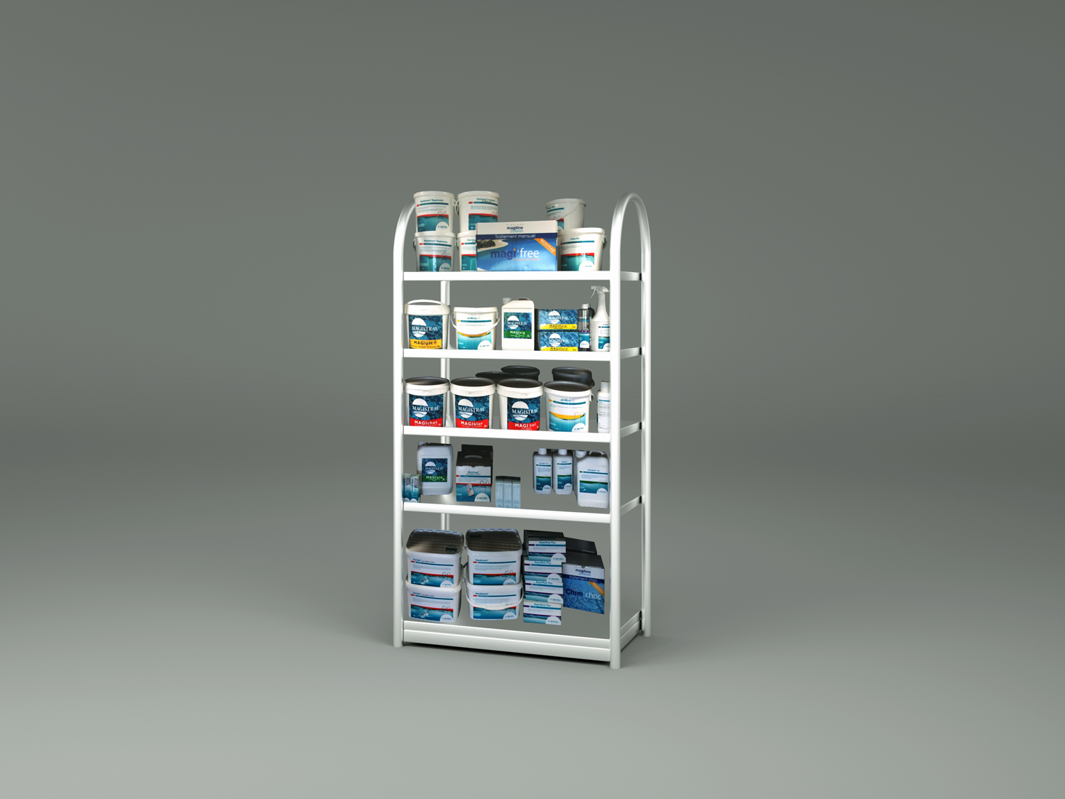

Thanks, but,yes, Alpha shadows enabled !
Attached render with problem.

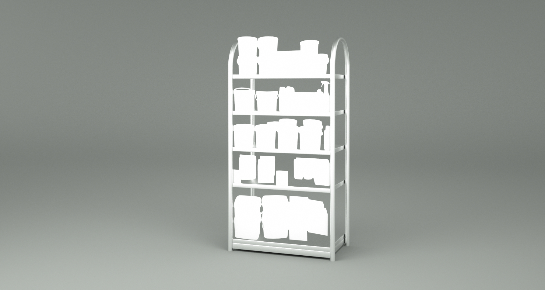

Another problem ! If i use Octane projection node, the products are white. I f i use UVMAP node, Products are goods (no cast shadows).

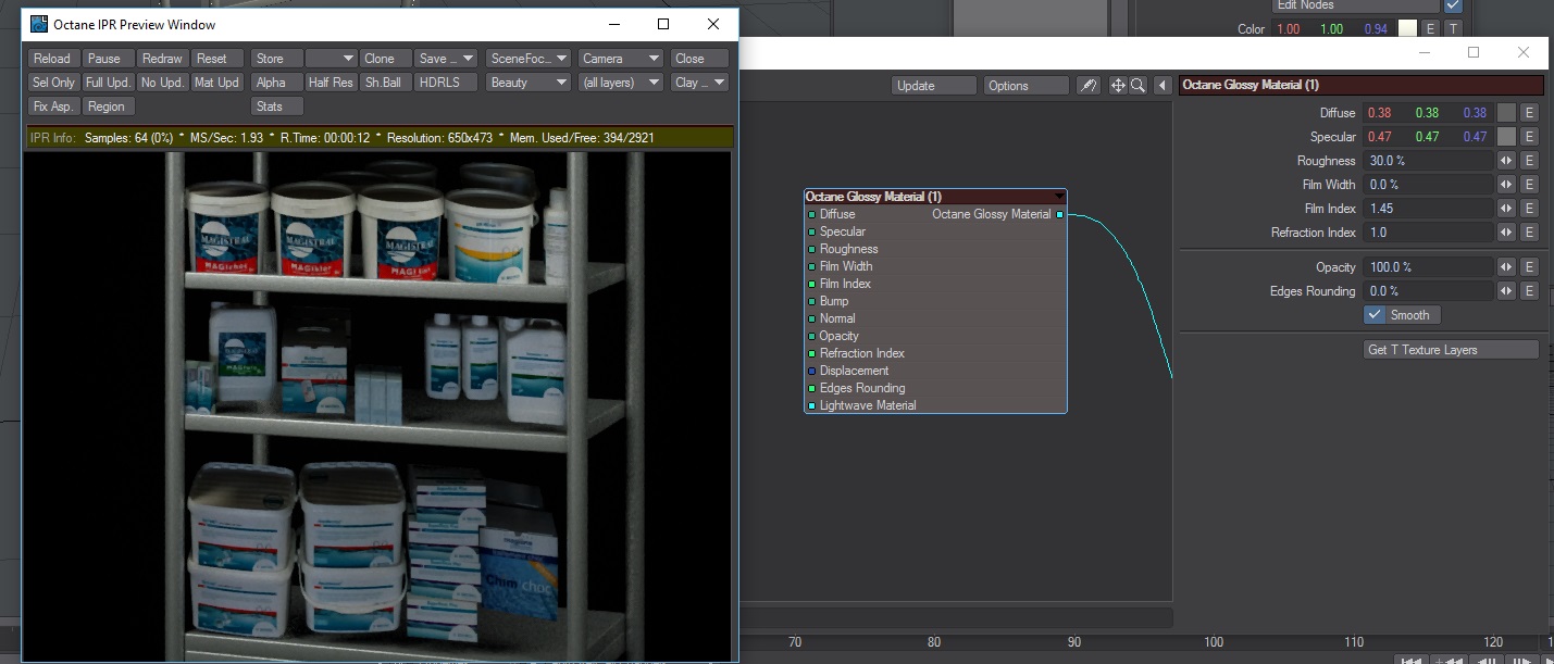

The shadows problem is related to the shelf material. It is too specular, with the diffusion parameter near to 0. Without diffuse reflection, you can't have direct light shadows.
-Juanjo

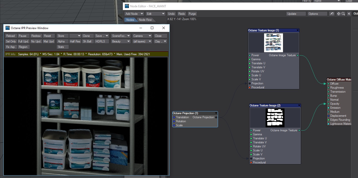

The projection node seems to work fine here, but you need to link it to both texture nodes.
-Juanjo

I'm ok for UV map, but i don't understand diffuse and specular. Can you show me your map setting to have cast shadow ?
BorderLine
Posts: 294
Joined: Sun Mar 24, 2013 5:30 pm
I'm trying with your setting, but no cast shadow.
I've seen you have a black background. Here is white !
